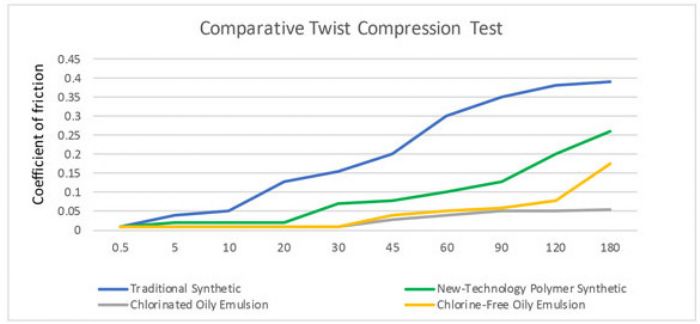

Comparative Twist Compression TestTo address these concerns, lubricant providers have developed synthetic products that will perform well for forming HSS and AHSS grades. By incorporating heat-resistant additives and devising new methods to increase the amount of EP additives in water-based lubricants, newer synthetic lubricants can perform well during stamping of high-strength steels.
Other types of lubricants have been found to perform even better on these steels, including oily emulsions with chlorinated paraffin. However, these lubricants can prove difficult to clean from parts, and chlorine has been prohibited in some areas of the world, such as Europe. Further, in 2015, the U.S. Environmental Protection Agency indicated that it may soon prohibit the use of chlorinated-paraffin-based lubricants in the United States. This warning led lubricant suppliers to develop high-performing lubricants without the use of chlorine, in most cases replacing chlorine with a combination of sulfur and phosphorous additives, with added boundary additives. Field experience and tribology testing on HSS and AHSS have shown that these chlorine-free oily emulsions can, in some cases, outperform water-based synthetics, and will perform nearly as well as chlorinated oily emulsions (Fig. 2). While some of these products may cost more per gallon than older-generation lubricants, the wrong choice in lubricant when working with HSLA, HSS and AHSS grades can lead to costly die damage and diminished part quality.
