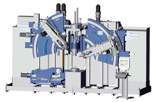

In 2017 Abacus Maschinenbau introduced its vertical spinning machines to the North American market with polymer cast frames for better vibration dampening and a vertically mounted main-spindle that provides increased stability. Servo drives on all axes provide for high positioning accuracy and precise part reproducibility. Servo power eliminates warm-up time and the high service costs common to hydraulic machines.
An automatic metal spinning machine in its most basic form consists of a headstock, tailstock and two-axis slide compound with a spinning roller attached. The numerical controls supplied enable the tool path to be CNC programmed off-line or at the spinning machine using teach-and-playback mode—sometimes referred to as programmable numeric control.
Early automatic machines utilized a template and single roller attached to a hydraulically actuated slide for forming, which also helped eliminate physical wear on the spinner. Today, most machines have automatic tool change devices or a multistation turret with different forming rollers, and cutting or trimming tooling ready to employ.
