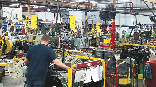

| At its 105,000-sq.-ft. main plant in Grand Haven, MI, Automatic Spring Products houses fourslide, tooling, assembly and stamping operations. Note fourslide machines in the foreground with recently installed servo-mechanical presses operating at the rear left. |
“The majority of what we stamp here is flat, with some limited forms,” says Nichols, “but to produce good parts in high volumes and meet tight deadlines, we not only must maintain dimensional tolerances, but also edge and surface quality on our tooling. We can’t afford to have punches that wear excessively.”

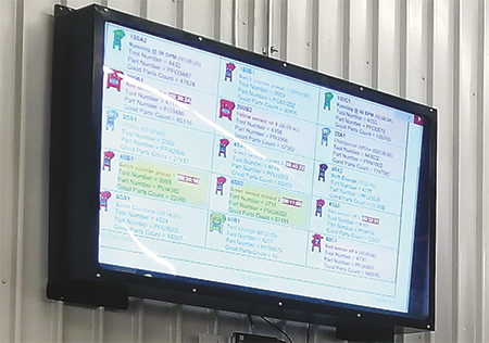

| Real-time production-tracking and OEE software helps keep work flowing, and will assist as Automatic Spring Products embarks on a robust predictive/preventive-maintenance (PPM) program for all of its tooling. The company is converting spreadsheets of meticulously kept tool-history records to database form in a transition from manual to automated PPM as a scheduling aid. |

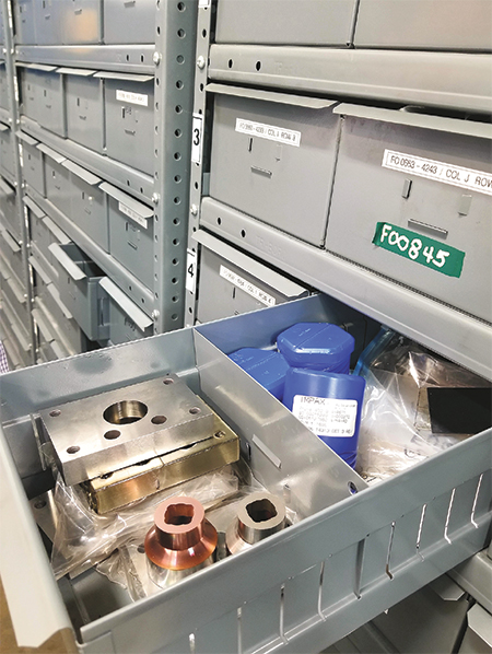

As important as longer tool life is to Automatic Spring Products, keeping components stocked and at the ready is just as vital. For example, high-volume work for a major automotive OEM must stay on schedule, and parts must maintain quality through runs that last into the millions. To keep on track, Automatic Spring Products has devised a rack system, with drawers organized to hold all manner of tool components. A Wilson Tool representative arrives on a biweekly basis to meticulously assess component quality and quantity, and present detailed inventory spreadsheet.
“We receive a spreadsheet of what is low and what replacements will arrive,” Nichols says. “We can see what continuously comes up low in inventory, and then bump up the quantity of that component stored in the drawer.”
