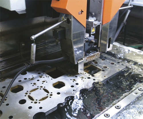

Over the last 3 yr., Oberg has invested more than $10 million in new machining equipment, including the addition of special machining platforms that the firm has customized to perform its proprietary Molecular Decomposition Process (MDP), shown here. During MDP, a cathode-anode relationship between the abrasive wheel and the workpiece enables stock removal as much as 80 percent faster than with conventional grinding.

Over the last 3 yr., Oberg has invested more than $10 million in new machining equipment. It also has continued to customize special machining platforms to perform its proprietary Molecular Decomposition Process (MDP). It uses the process where surface quality of die components is absolutely critical—typically found in Series I and II dies, but occasionally specified in Series III dies as well. “
During MDP, we establish a cathode-anode relationship between the abrasive wheel and the workpiece,” Rugaber explains. “As a result, we can remove stock as much as 80 percent faster than with conventional grinding.”
Using MDP, which Oberg now has installed on more than 10 grinding machines (three of which are dedicated to toolroom activities, the rest for production machining), allows full-depth cuts to be made in one pass with surface finishes to less than 1 Ra.
