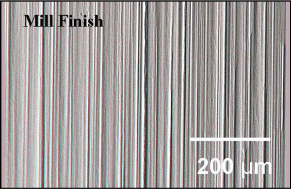

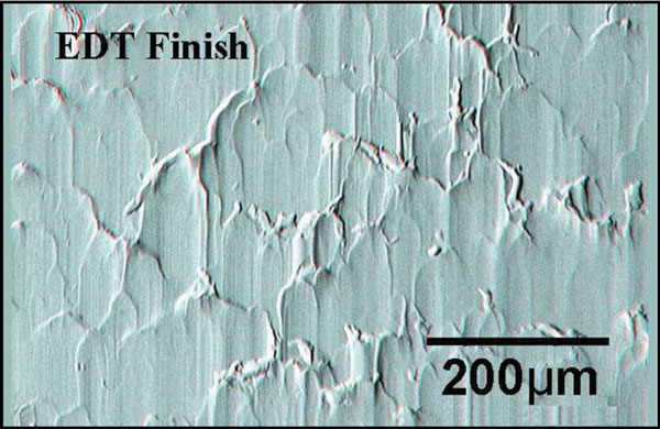

Fig. 3—Aluminum-alloy surfaces

Typically, stainless steels exhibit a relatively smooth surface with a low Ra. Aluminum-alloy surfaces typically exhibit either a directional mill-finish or have a non-directional electro-discharge texture (Fig. 3). Carbon-steel surfaces are slightly rougher and usually nondirectional.
