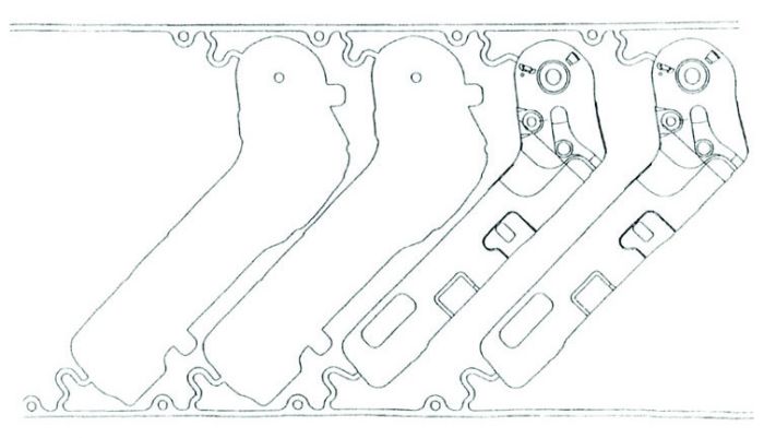

Fig. 1—Progressive dieTransfer dies can be mounted in the same press and use the same feedline as progressive dies, with parts transported from station to station mechanically rather than via carrier ribbons attached to the coil. Die construction tends to be less complex than progressive dies and provides more flexibility for rotating parts, with raw material blank- or coil-fed into the die.

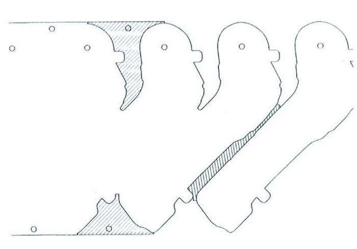

Fig. 2—Coil-fed transferThe first step: Create a strip layout for a progressive die and a flow chart for a transfer die. A flow chart shows the work to be performed in each station. Next, consider how the blank will load into the transfer die. Possible methods: coil feed, coil transfer, zig-zag feed or blank destacker. Compare the material use for several methods and calculate the cost difference (see the accompanying table and figures).

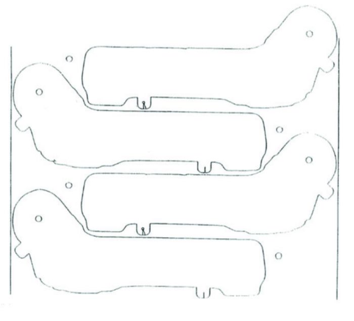

Fig. 3—Blank-fed transfer  (nested blanking die)Another design consideration: cam accessibility. Cam operations in progressive dies usually are minimized to fit within the confines of the pitch length and carrier design. Cam operations in transfer dies can be designed for maximum accessibility and adjustment.
