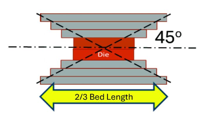

Fig. 1The tonnage rating of a press represents the maximum load (in tons) that a press can withstand under normal operating conditions without causing damage to its structure or drivetrain. The capacity rating of most presses assumes that the die length spans across at least two-thirds of the press slide.
When the die covers less than two-thirds of the bed length, the maximum allowable tonnage is reduced to prevent damage to the slide caused by concentrated loads applied between the pitman connections (Fig. 1).

Fig. 2The press technician has two choices: Ask to have the die reassigned to a different press, or redistribute the die load across a longer portion of the press bed.
To redistribute the load, create a pyramidical buildup of parallels above and below the die, providing there is enough press shut height available to accomplish this.
To create the buildup, the ends of each parallel should intersect a theoretical 45-deg. angle originating at the die centerline (Fig. 2). The length of the parallels serves to increase the effective length of the die, and the maximum force can be recalculated based on the longest parallel length. If enough parallels can be added to cover two-thirds of the press bed, the full rated force of the press can be applied to the die.

Too small of loads and offset loads are two of the most common mistakes people make in using presses. The bed, slide and crown are almost always designed for central loads and 2/3 bed coverage to avoid excessive deflection and cracks and overloading slide connections.
