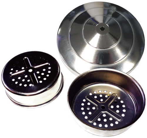

| Acro stamps these parts for the iconic barber’s jar of combs on a 110-ton servo press. It was able to reshore the job from China thanks to the ability of the servo press to draw and form the prepolished stainless steel without affecting its surface finish. Under previous production methods on a conventional press, the stamped parts required a secondary hand-finishing process. |

Asked to elaborate, Wolfenberg credits the flexibility and stroke control that comes with servo-press technology with Acro’s ability to add deep drawing of stainless steel to its resume. Case in point: stamping parts for the iconic comb container found in nearly every barber shop and hair solon. To form the top cover of the container, Acro’s 110-ton servo press performs a nearly 2-in. draw on a 4-in.-dia. blank of 0.012-in. stainless steel. The press also forms the stainless-steel strainer that sits inside the comb container. Both jobs had previously been offshored to China, and Wolfenberg is understandably quite proud to have reshored the work.
“We can draw the cover in one operation in the servo press,” he notes, “impossible to do in a conventional mechanical press and much faster than if we were to run them in a hydraulic press.”
Acro was able to reshore the job thanks to the ability of the servo press to draw and form the prepolished stainless steel without affecting its surface finish. Under previous production methods on a conventional press, the stamped parts required a costly and time-consuming secondary hand-finishing process.
