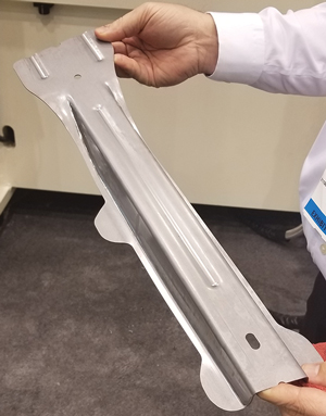

As an example, Patil describes a blanking die placed in a standard crank-motion mechanical press. Measurement reveals 114 tons of forward press force and reverse tonnage of 9 tons. The same die then is placed in a servomechanical press, with the ram descending rapidly prior to slow blanking. The bottom-stroke speed reduction lowers the noise level, from 101 to 75 dB, but also reduces forward force to 104 tons, and reverse tonnage to 2.6 tons, well within the recommended reverse-tonnage limit of 20 percent.
As part of its servo-technology-intensive exhibit, Aida-America presented this demonstration of a 70-percent-plus reverse-tonnage reduction at FABTECH, via a model DSF-N2-3000, 300-ton, two-point straightside servo press, as part of a full progressive die production line blanking near-fine parts. The demo showed how servo near-fine blanking can produce a >90-percent burnished surface with a straight edge, exceeding the typical 70 to 80-percent burnished-edge requirement of many applications, according to Aida-America officials.
The combination of DSF-series accuracy and programmability reportedly transitions production of near-fine parts from a high-cost, labor-intensive machining process to a more efficient, economical stamping process, leading to reduced per-piece costs.

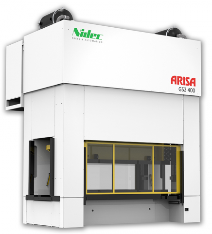

In step with this evolution in technology and in application optimization, Nidec Arisa has rolled out the Arisa GS2 servo-press series (pictured on next page), offering integrated automation such as described above in capacities from 3150 to 8000 kN.
Key to this series are precision kinematics that enable quicker system response and higher production rates than possible in previous series versions, according to Nidec Arisa officials. Features include eccentric wheels with double-helical gearing, allowing for smooth operation, increased power transmission and higher durability; and zero-clearance slide guiding that improves die setup and operation. Standard on this series, the Desch planetary gearbox reportedly reduces drive train inertia to provide quicker acceleration and faster stopping times. And, the Siemens energy-management system provides maximum energy efficiency and low power cost per part, according to company officials.

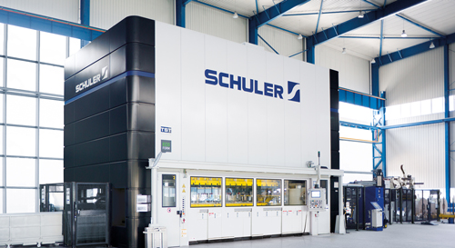

As its most recent contribution to Industry 4.0, Schuler touts the Smart Press Shop. In the intelligent and fully networked press shop of the future, company officials postulate, stampers accurately can predict potential downtime with the aid of sophisticated sensors and actuators, along with the data they collect, to avert this downtime well in advance. Today, with Smart Press Shop, users can ensure productivity and increase part quality while reducing energy requirements. The Machine Monitoring System, the heart of the Smart Press Shop, features six different function areas that collect, analyze, store and evaluate production conditions. Users operate and control the system, compatible with new and existing machinery, including Schuler’s servo presses, directly on their plant equipment, via their servers, over their networks, and in the future also from the cloud.
Machine components are monitored for changes, wear and damage in order to optimize the maintenance process. For this purpose, regular stamping-system test runs gather vibration data and measure torque progressions and energy consumption, with the data then stored and compared. In addition, to assess wear, the Schuler solution considers the load as well as the actual manufacturing process through process monitoring.
Since 2016, Schuler servo press lines have been equipped with sensors in the slide and bed as standard. The sensors measure the acceleration per stroke, enabling users to monitor the condition of the systems and the forming processes in detail. Sensors also can measure the vibration in the engine bearings, which in turn indicates possible wear at particularly critical points such as gearwheels and axles. In addition, demand for electricity, water and compressed air can individually be identified, from the blank feed and individual presses to bed cushions and blank destacking.
And, the company’s Smart Assist software for servo-driven presses helps accelerate production startup. The software guides a user through the process step-by-step with the aid of videos and graphics, optimizes the movement curves of the slide and transfer fully automatically, and transfers the data to the overall system. Compared to setting up the system manually, which may take as long as 8 hours for an expert, Smart Assist reportedly reduces the process to just 30 minutes.
Servo press technology from Schuler includes TwinServo systems, with two separate and electronically synchronized torque motors located in the press bed. The result: lower machine heights and reduction in springback by 30 percent, as well as improved sound insulation and energy efficiency. Arrangement of the two decentralized drives enable sufficient space for drawing cushions and scrap shafts.
