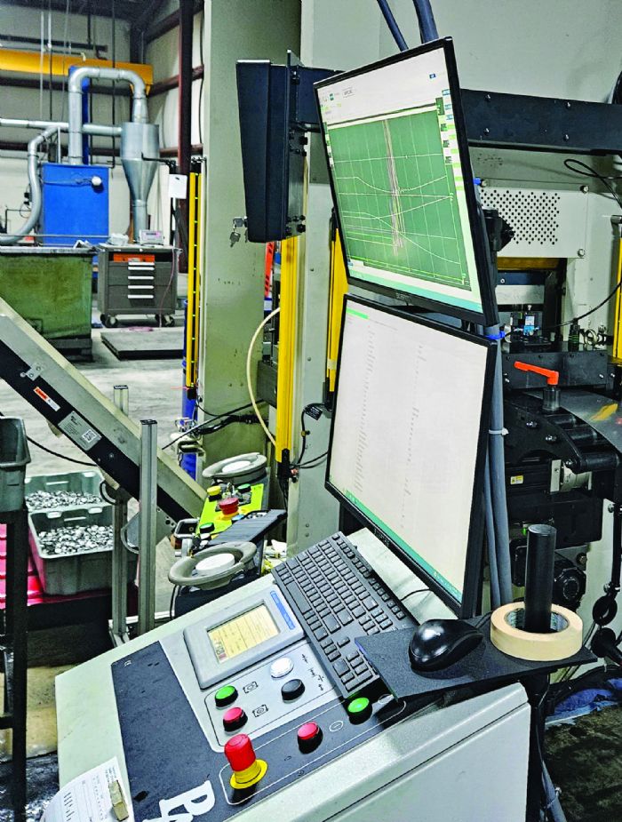

- An additional PC with double screens on each servo-press cell for program management and other functions

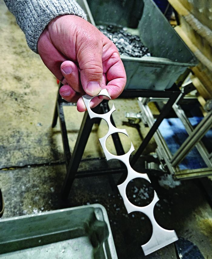

“Prior to the zig-zag feeds, we’d slit our own strips from wider coils, requiring us to carry a lot of raw-material inventory,” Nevin explains. “With the new feeds we’ve eliminated the slitting process completely, and gone from some 350 inventory items down to just 20 or 30.”
Adds Dawson: “We have so many part numbers for the huge variety of plugs … in the thousands. But some of these run in production only once every few years. So, I captured all of the various feed programs on Excel spreadsheets, and saved them on our server rather than on the feed-line control.
“Then, program management becomes the challenge,” he continues. “The feeders have a PLC at their core. I devised a process for communicating over the network from the server to the PLCs. And, I had to account for the fact that each feeder is designed to work independently and not on a network. So, I had to dig into the PLCs and change some settings to allow them to communicate over the network.

“And,” Dawson adds, “we’re working with Komatsu to incorporate its VIS (Visual Inspection System), which eventually will allow us to monitor on the press control the actual working loads (total/left and right) and slide position for each press.”

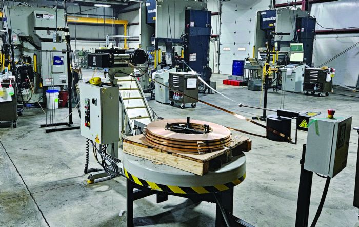

State-of-the-Art Feeding
Explaining the zig-zag feed’s operation, P/A North American sales manager Don Frank says, “The feed creates a nested product along the width of the coil. The nest at Hubbard is five-out, almost linear—inline but staggered back and forth, with an index down. It’s the first time we’ve engineered a feed profile like this, a multi-out with staggered feed. It allows Hubbard to really optimize strip width and material yield.

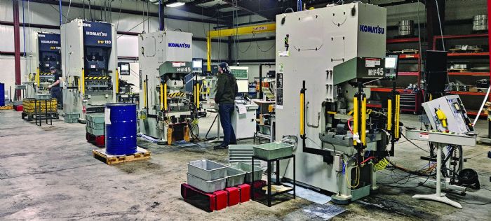

“Two of the Komatsu servo presses run the master dies designed to handle all of the expansion plugs,” he continues. “And, our prog dies are engineered to the standards of those presses as well. We built all of new die shoes and kept the retainers, so everything we stamp can run in these presses. Our press utilization has gone up considerably as a result. That, in turn, helped us justify the investment in the zig-zag feeds.
“Bottom line,” Nevin wraps up, “we’re now processing all of our stampings in four presses running full time, replacing 12 presses that used to run sporadically. That translates into less labor needed to tend to our pressroom operations. We’re four times more efficient on labor using the master dies, and two times more efficient on prog-die stamping. Material utilization is up, setup times are averaging 20 min. compared to 1 hr. or more, and inventory-carrying costs are way down.” MF
