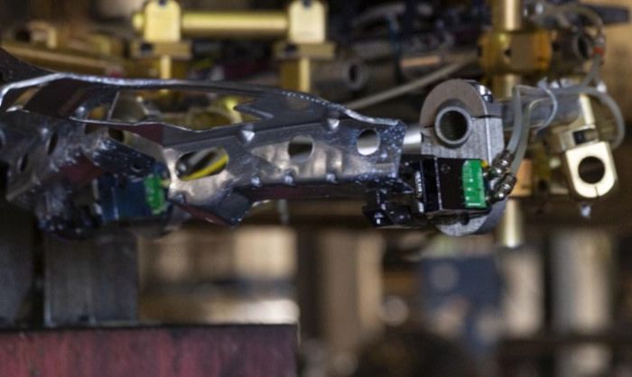

transfer-system-motor-city-stampingTransfer. Another transfer press would provide more capability to do a wider product range, not only for GM, but also for new OEM business, Davis said.
The difference between a progressive die and a transfer die press is primarily how the part is moved from station to station, Davis explained. Instead of having carrier tabs that carry the part all the way to the end of the progressive die and then are cut off at the end, the blank is formed as it goes through the tools. Finger tools pick it up and move it.
“Typically, the coil comes in and a blank is cut off in the very first station. Then, the transfer fingers that are mounted on a transfer bar come in and actually pick up that blank and move it through the stamping stations to form the part.”
The stamper was seeking the advantages that a transfer system offers over progressive die systems, he said. “You can reduce your blank size. You don’t get a lot of scrap. Also, you can transfer much bigger parts because you can use the entire coil width. In fact, you can press parts that are larger than the coil width by running them on a diagonal.”

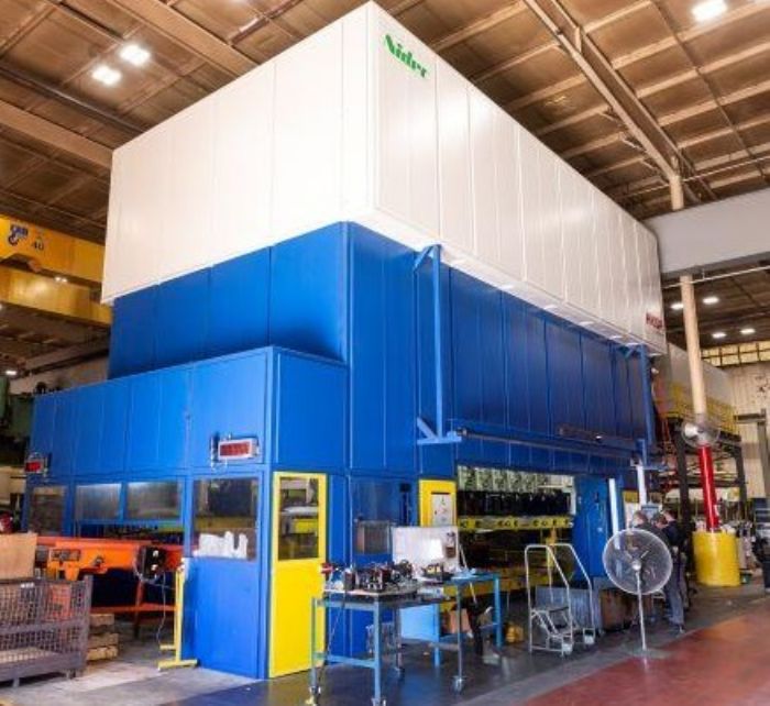

The plans to expand the business began over two years ago, but were then delayed due to the pandemic, Davis relayed. “We were fortunate to finally find a new Nidec Press & Automation Arisa servo transfer press, which was built for another company that could no longer take possession.”
The press system includes some unique technology, according to Nidec Press & Automation North American Automotive Market Segment Director Joel Wuebker.
“This system included a Nidec Arisa press, high dynamic transfer, and moving bolster with Nidec CHS thread table, straightener, feed, and coil car—all of which are uniquely integrated as a total OEM system.
“Many helpful features in this system like the antivibration technology, the moving bolster transfer technology, and the common HMI were designed with the operator in mind to create an efficient experience and simplified functionality,” said Wuebker.
Coil Handling. The Nidec CHS HDX coil line comprises a thread table, straightener, feed, and coil car. Its capacity is up to 72 in. wide and handles up to 8-mm material thickness for increased material flexibility. “So, it gives us the capability to do very large and also very thick or high-strength parts,” Davis said.
Moving Bolster. One unique aspect about the press system is that the die cart function is replaced with a moving bolster that is integrated with the press and is operated from a common HMI. “It is actually part of the lower bolster rather than a separate unit that has to be moved out once the die is in place. It goes into the press and stays in there during the operation,” Davis said. The moving bolster moves the die in and out on a steel rail that’s embedded in the floor.
Scrap. Because the press was installed in an existing building, there were no underground conveyor pits for scrap, so side scrap ejection trays were installed instead. Scrap drops off and down a shoot and out of the back of the press.

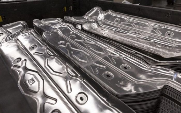

heat-shields-motor-city-stampingThe new press has been up and running and producing parts. In June, the company initiated production, running only reliable, large progressive dies in the transfer press to debug the press and coil system. The initial transfer job beginning July 1 was a hood reinforcement part for GM.
Some of the parts the company is stamping on the press are new, and some are in a “sundowning phase,” Davis said. “We have more than 400 GM part numbers alone that are in production today. Since we’ve been supplying to GM for over 50 years, we have literally thousands of active part numbers. You know, you continue to make service parts for 15 years. We still have a tool here that makes parts for the Chevy S-10 pickup and a van that they've been making since the 70s.”
One part and its variations that Motor City Stamping now produces that it anticipates “sundowning” is heat shields. “That’s $7 million worth of business that we're potentially going to lose in the next few years because of electrification,” Davis said. Another part is a thick, heavy bracket that holds up a diesel fuel tank.
