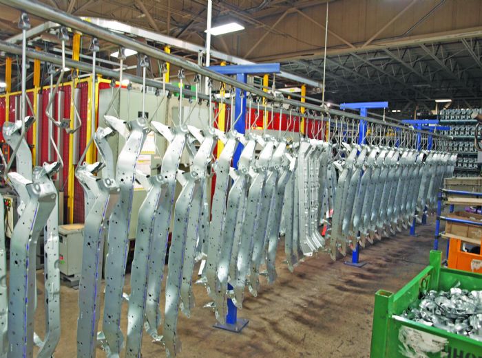

Photo A front end supports at Kirchhoff AutomotiveOn the Tecumseh 400,000-sq.-ft. plant floor, one-third devoted to stamping including 14 press lines, toolroom and die storage, Forquer eyes servo press technology as providing a sizable competitive advantage, particularly for forming advanced high-strength steels, and the facility has commissioned six new servo presses since 2017. In all the facility boasts 14 presses, from 250 to 1650 metric tons, including two new 1650-ton servo presses. The facility produces an average of 50 million stamped parts annually.

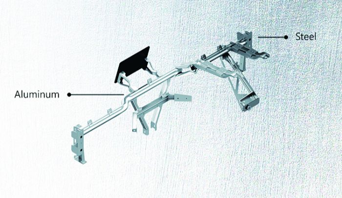

Hybrid IP cross-car beam from IAADetailed in a description of its exhibit at the show, key features of its innovative new CMS include:
  • Load paths and components matched to central load introduction.
  • Continuous energy absorption over long intrusion paths without complete failure.
  • Use of pre-galvanized steels for the greatest level of corrosion protection, joined using a gas-metal-arc-welding process optimized to ensure minimum porosity and good paint adhesion.
  • First-time use of a fully laser-welded CMS.
  • Economical lightweight design through optimum use of aluminum and steel components (see the accompanying photo of a hybrid cross-car beam).
  • Use of steel in the driver-side area to meet the highest stiffness requirements in tight installation spaces.
  • Use of aluminum in the center and passenger areas to meet lower stiffness requirements, more favorable installation space conditions and maximum lightweight design potential.

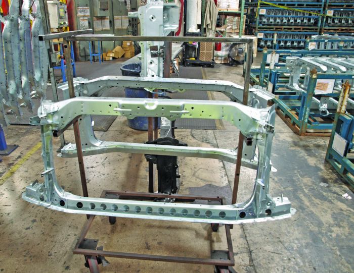

While the Tecumseh facility also welds plenty of its stampings, thousands of stamped parts make their way upstate a few miles to the firm’s relatively new welding facility in Lansing. Commissioned in 2015, this BIW-welding facility initially tooled up to work on the Camaro, and in 2017 it also took on the GM C1Y platform—Chevy Traverse and Buick Enclave. Plant manager Missy Smith oversees the facility’s 25 arc- and resistance-welding cells, many of them robotic, designed over four standard layouts to quickly adapt to handle some 80 finished-good assembly/subassembly part numbers.
“With our four standard cell configurations,” Smith says, “we quickly can adapt them for new programs and product configurations. This particularly helps as we take on more BEVs, which might only require annual production volumes of 50,000. Here our flexible yet standard cells allow us to start a production run in one or two cells and then add cells as volumes ramp up over time.”

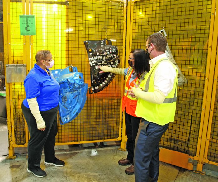

People Standing by partsIn addition to her plant’s impressive safety performance, Smith also points to another recently enhanced key-performance indicator—quality.
“We of course have scorecards with the customers,” says Smith, “and also are proactive here. We worked with the management team at Tecumseh and developed what we call the Operational Quality System Enhancement Audit. This audit comprises 11 or 12 questions that our salaried people ask at each work center on the floor, and can be completed in just 15 to 20 min. The goal is to ensure that all of the operators understand their process and work instructions, and help us identify any gaps. It’s really helped to develop the teams out on the floor, and it also gets our management team to interact more with the teams on the floor.
“We presented this program to our supplier quality engineer at our customer,” adds Smith, “and he loved it. We also added it to Go Bench and all of our other U.S. and Canadian plants now conduct these same audits.” MF
