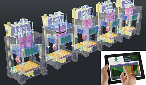

The I-Press multipoint edit screen (lower right) allows for quick customization of the stroke profile. Pictured is a CAD drawing of a high-volume tandem servo-hydraulic press production line.
