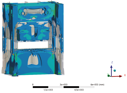

Some manufacturers ensure press longevity by performing finite-element analysis (FEA) on the press frame, drive components and slide assemblies to optimize construction and prepare the frame for dynamic forming processes.
Similar to a standard mechanical press, the frame of a servo press and slide assembly provide mechanical rigidity and resistance against deflection during the cycle. Most servo presses use a steel-plate-welded assembly with power generated by servo motors in various configurations based on the required press force and forming task. Low-stress annealing of the welded parts has become standard. Some manufacturers ensure press longevity by performing finite-element analysis (FEA) on the press frame, drive components and slide assemblies to optimize construction and prepare the frame for dynamic forming processes.

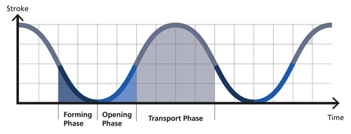

Important Die-Related Factors
Attention paid to three important factors—die process, die opening and transport window—pays off in terms of part quality, process reliability, cycle-time optimization and die life.
When it comes to the die process, consider the following:
  • Adaptation of forming, drawing or cutting speeds for specific parts and process requirements;
  • Fluctuation in material and cost quality; and
  • Integration of secondary in-die processes such as welding, joining, laser operations, weld, clinch-nut and stud feeding, thread forming and adhesive bonding.
Examples of preprogrammed slide-motion curves.
Related to die openings, consider:
  • Adaption of the movement in this phase to provide clearance and accessibility for automation equipment;
  • Active in-die function—springs, sliders, part lifters, thread formers or part-turnover stations—that can be performed with high process reliability; and
  • Maximum permitted opening speed with regards to nitrogen cylinders in the die.
Regarding transport windows, consider:
  • Synchronization with automation modes and functions;
  • Clearance and accessibility in the die space.
