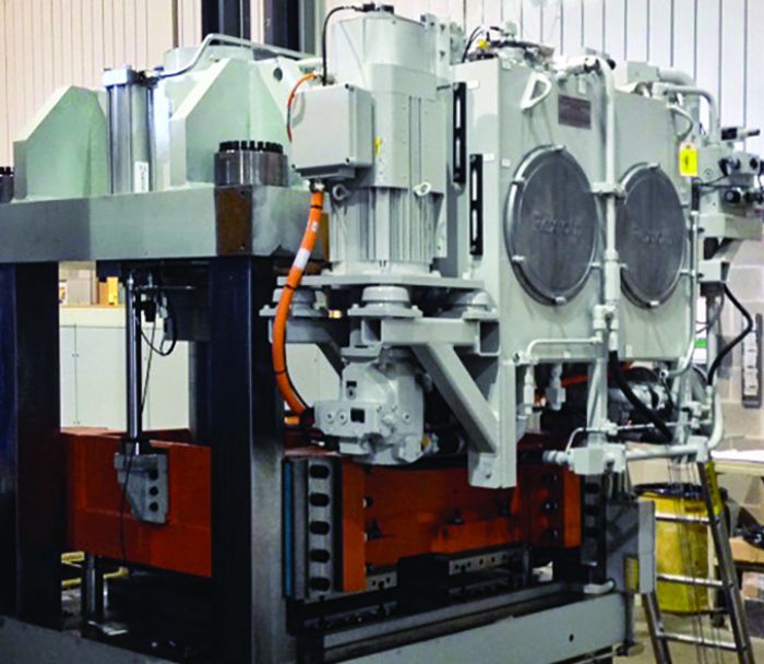

Piston Pump on a Servo MotorA misperception exists that a “servo press” is a completely different type of press, but what many people call a “servo press” actually is a servo-driven mechanical press: a mechanical-geared link press in which the flywheel has been replaced with a servo drive. Alternatively, servohydraulic presses integrate servo control directly into the hydraulic system, allowing for variable flow and precise force control. Servo technology has emerged in the hydraulic press arena as a means of reducing energy consumption, exerting greater control and enhancing flexibility.
Servohydraulic technology combines the reliable force of hydraulics with the precision of servo-controlled programmable motion, allowing manufacturers to use only as much energy as the operation requires while improving accuracy.
Servo-controlled valve technologies. Servo technology can be integrated into hydraulic presses by employing servo-controlled valves, and by powering the pump with a servo motor. Software and servo-controlled valves work together to control the hydraulic force of the press.
Servo-controlled direct-drive pumps. A servo motor-driven pump eliminates excess pressure drops and idling motors. Servo motors can control pump flows to reduce the wasted heat and energy in the system. Putting a servo motor on a pump allows control of the oil flow just by changing the direction and speed at which the motor spins. In addition, the servo motor makes for a more accurate, repeatable press. A servo motor might also be combined with other technologies, such as a two-position piston pump—low-flow and high-flow. That way, the control system can vary the pump flow and the motor speed.

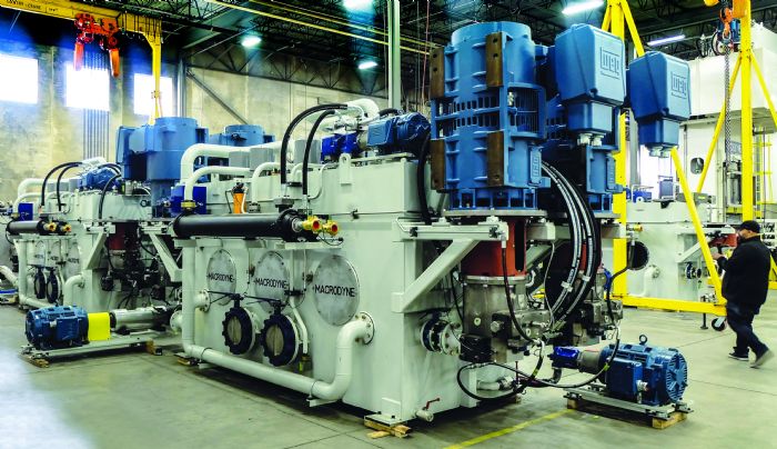

High-pressure Pumps with Electronic ControlsA hydraulic accumulator, a pressure vessel used to maintain pressure and recapture and store energy, enables a hydraulic system to cope with demand extremes with a less powerful pump. If a metal former’s operation requires a powerful energy jolt, but only at intervals, energy can accumulate while the press sits idle, such as during part removal or material reloading. Basically, the peak-horsepower requirement is averaged over an interval of time.
How it works: The pump reserves excess energy in a high-pressure nitrogen accumulator, built with a divider between nitrogen on one side and hydraulic oil on the other. As oil is pushed into the accumulator, the nitrogen compresses and creates stored energy in the system. Then, in response to a temporary demand surge, a valve opens and releases this energy as the compressed nitrogen forces the oil quickly into the system.
Instead of employing a 1000-hp hydraulic power unit for an operation needing an energy surge once every 30 sec., the press can use a 230-hp motor on the unit that cycles continuously, storing unused energy in the accumulator during the rest of that cycle. A press needing perhaps 1000 amps at peak times can cycle at 300 amps due to no huge peak at any given time. That constancy simplifies energy consumption management. The press operates at a reduced peak horsepower, and as a result, lowers its peak power demand significantly.

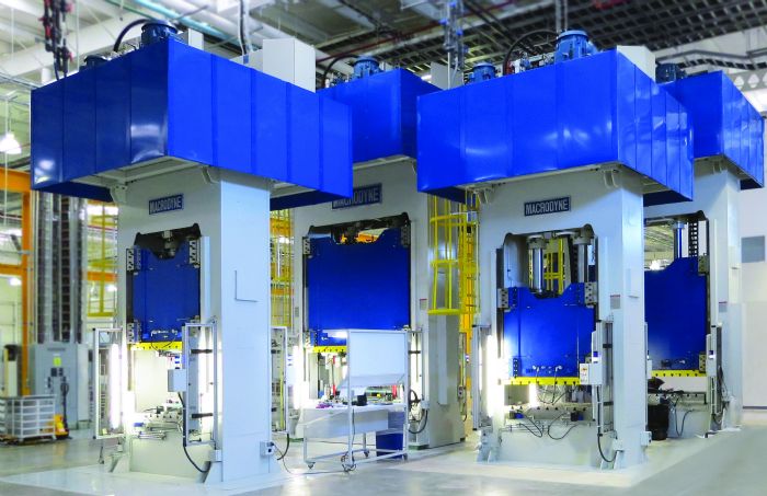

Synchronizing Press Fleet
When metal formers operate multiple stamping presses running slow applications, they can program them to work as a fleet in a staggered pattern, rather than simultaneously, to eliminate huge power draws to the plant. Everything works in a coordinated way to suppress the plant energy draw.
