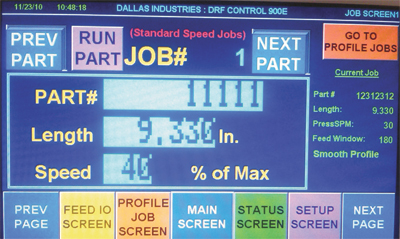

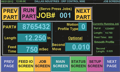

As these images from Dallas Industries illustrate, while the control for a coil feed installed on a conventional mechanical press (left) works from data input for feed length and speed (as a percentage of maximum), the feed control for a servo-drive press (right) is more interested in feed time (in msec.) and motion-profile type.

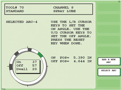

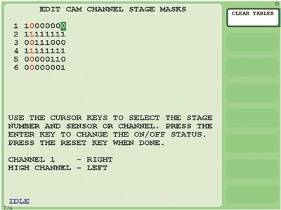

A—This screen allows the user to select which cams fire on which stages. The stages are listed on the left column (1-10)—in this example, only six stages are being used. The series of 1s and 0s indicate which cams will be active on each stage. The control stores separate sets of masking information (for sensors and cams) for each job.

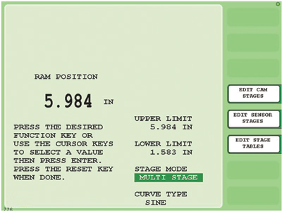

B—This programming screen addresses ram position. The user can select the stage mode (single or multistage) and the motion-curve type (sinusoidal, linear or one of three different asymmetrical curves). He also can set the upper and lower limits.
C—Here we see the programmable limit switch (cam) timing for channel 8, which—according to the mask shown in screen A—will turn on during the second, fourth and sixth stages of motion.

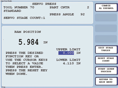

  D—On this main run screen the operator can view the current stage, ram position and upper and lower ram limits. A function key allows him to start the self-learn process that allows the control to learn the stage motion for the job.

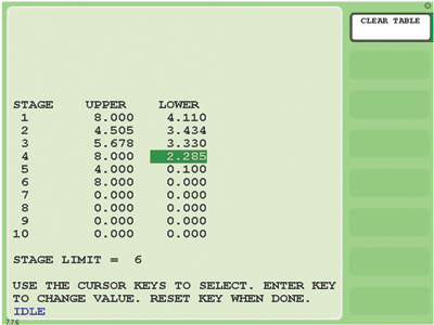

E—This screen shows the upper and lower ram limits for each programmed stage (six stages shown here). These values can be user-entered or can be automatically created as a result of the self-learn process.

“With a conventional press, we run the feed in impulse mode,” Chacko continues. “The press control says feed and we feed. Then we signal when the feed is complete so that the press can stroke. Now we’ve learned and adapted the technology so we can synchronize our motion with that of the servo press, and still develop a smooth motion profile in the time allotted.”
What Chacko is alluding to is Dallas’ ServoPressSelect feed control, slated for release by year-end. He says the control will allow servo-press users to select from among five types of feed profiles to match the variety of tasks that a servo press can perform.
“ServoPressSelect is an offshoot of our ProfileSelect (introduced in 2010),” explains Dallas president Joe Gentilia. “The idea is to minimize the stress imparted on the feed’s servo drive and mechanics, by creating a feed speed and acceleration profile. We look at the time available to feed and design the motion profile—slowly accelerate to feed speed, and then decelerate—to that allotted time.”
The five profile types available:
• Sinusoidal
• Triangular
• Trapezoidal with three equal motion segments
• Trapezoidal with 1/4-1/2-1/4 motion segments
• Electronic gearing
As a result, the human-machine interface (HMI) of the new control looks different than that for the standard feed control. In place of feed speed (as a percentage of maximum), the control needs to know feed time (in msec.) and the motion-profile type.
“Most stampers use the sinusoidal profile,” says Gentilia, “gradually ramping up feed speed during the first part of the feed cycle, then ramping down from peek speed at the end of the cycle. But stampers, as they become more familiar with the flexibility and opportunities afforded by servo presses, will realize some definite opportunities to use other profiles.
“For example,” Gentilia continues, “a more aggressive motion profile (triangular or trapezoidal) will allow higher run rates or other applications where there’s minimal time to index. And the added acceleration with these profiles also can help if you want to kick the part off the end of the die.”

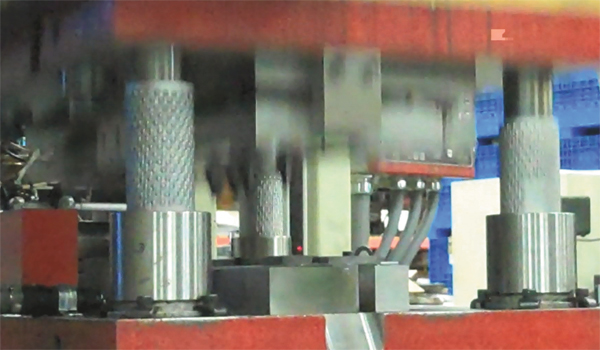

This screen capture from digital video footage of a servo-drive press in action, provided by Anchor Danly’s Ray Osborne, illustrates what can happen to ball-bearing cages when the ram accelerates rapidly from BDC and then reverses quickly from TDC. At this point in the stroke, the ram is rapidly accelerating downward just milliseconds after TDC. The cages have lost their timing and position, ultimately leading to performance problems and eventual damage to the retaining hardware.

Conventional timing methods used for flywheel/clutch-driven mechanical presses, where everything happens in a repetitive cycle through a complete revolution, will not work with servo presses. The activities in the press cell—feed, part off, etc.—all happen in a repetitive cycle with a conventional press, but with a servo press this might not happen.
“As a result, we only want to activate timing outputs at certain stages,” says Finnerty, “and activate or monitor sensor inputs at other stages. So, for example, we may only feed the first stage of the cycle, activate cutoff on the last stroke and look for part ejection on the final stage.”

The control can monitor and direct as many as 10 stages of slide motion, although Finnerty says even the most complex jobs experienced so far have required control of only five stages (defined as a change in slide direction, not speed).
“Lastly,” adds Finnerty, “the control is self-learning, enabling it to capture the motion profile for a job when operating in the ‘learn mode,’ and storing the data as part of a part recipe.”
No need for the operator to enter parameters for each program—which can become quite complex for servo-press applications.

“Everyone thinks that once the press moves off of bottom-dead center (BDC),” Osborne says, “that the work is done. But the rapid upstroke acceleration and velocity from 180 deg. to top-dead center (TDC) can seriously impact the performance, over time, of a host of press-system components. In-die tapping units, cam-slide units, ball-bearing guidance systems, nitrogen systems, pad-retaining hardware and other components are potentially in jeopardy.”
To illustrate, Osborne describes a servo-press installation where he recorded digital video to illustrate what can happen to ball-bearing cages when the ram accelerates rapidly from BDC and quickly reverses direction from TDC. It’s not a pretty sight.
“When the ball bearings are disengaged from the preload (during the upstroke), the ram reverses direction and accelerates downward so quickly that the cages are actually suspended in mid-air,” says Osborne. “You can see it on the video. The cages immediately lose their timing and position. In this scenario, the ball bearings are forced into a ‘skid’ condition, causing the guide components to overheat and eventually scoring the guide pin and bushing.”
There are options for dealing with this condition, explains Osborne, in particular changing the length of the guide pin or bushing to ensure the ball bearings unload as close to TDC as possible. Or, the stamper can select a combination of components that ensures some bearings are als under preload—commonly referred to as Type 1 operation. But, as many stampers know (particularly those working in the high-speed canning industry), Type 1 operation often can lead to a phenomenon called “cage creep.” This, explains Osborne, refers to the tendency of a rolling-element retainer cage to gradually deviate from its nominal TDC and BDC positions. Certain measures must be taken to guard against cage creep.
