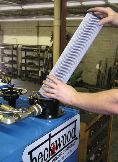

Check and change your oil filter regularly to reduce the risk of oil contamination. |

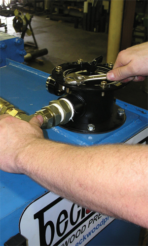

Tighten nuts and bolts to the proper torque specifications for optimum press performance. |

• Monitor the nuts and bolts. Press structures rely on a number of nuts and bolts for efficient operation. Among the connection points to be monitored: the cylinder attachment. Upon leaving the press-manufacturer’s facility, cylinder-attachment bolts should be tightened to the proper torque specification and baselines should be applied that aid in the monitoring of these fasteners. Many presses carry marks on all attachment bolts when they have been certified to the proper torque. In addition to cylinder-attachment bolts, bolster-plate and tie-rod pre-tensioning nuts should be monitored regularly.
Monitor Beckwood• Use clean oil. Oil contamination causes many a hydraulic-component failure, and can lead to complete system crashes. Most hydraulic systems can be run with simple return-line filtration circuits using 10-micron filters. However, higher-performance systems using proportional or servo valves require a more stringent filtration system and the use of inline pressure and return-line filters. Regardless of the level of performance, shops should sample the oil in each press periodically and analyze it to verify cleanliness. Also, the press manufacturer will specify the type of filtration required for each system and can act as a reference for any questions regarding oil cleanliness.

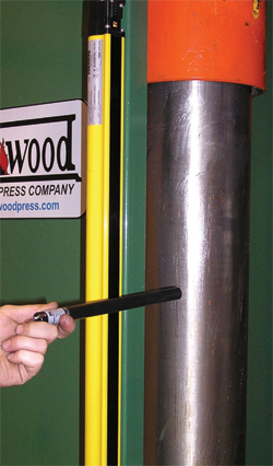

Monitor and ensure the reliability of
safety apparatus, such as the light curtain shown here, to make sure
the press operates as designed and that operators remain protected. |

• Monitor safety systems. Safety systems serve a valuable purpose in the operation of hydraulic presses. These important systems should be tested on a daily basis for reliability. Light curtains, gate interlocks, safety mats and the E-stop safety circuit should als be tested prior to press operation. Should any defects be discovered, immediately lockout the press system to allow for proper servicing.
