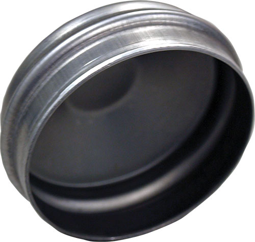

Case in point: a wheel-bearing cap FCA brought to Clips & Clamps a few years ago, which had been manufactured in Europe for the Fiat 500, and which FCA sought to source in the United States when it launched vehicle production in Toluca, Mexico.
“We form a lot of brackets and stampings in progressive dies,” says tooling supervisor Jeff Szarek, “but we do not have a lot of drawing expertise, nor the equipment to do so. However, FCA really wanted us to produce these caps (called out as ‘grease cups’ on the engineering drawings), which we all felt were perfect for forming on an eyelet press. As we don’t have that equipment, in order to satisfy FCA we sought a solution for drawing the parts on our 300-ton mechanical press.”

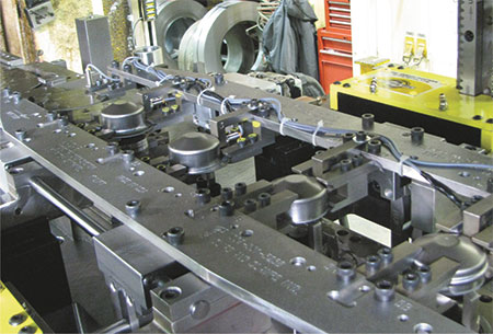

Part features—specifically a tapered body and an offset bead around its circumference—meant that attempting to produce the part in a traditional progressive die would require secondary operations. In an effort to avoid secondary ops, and to optimize material utilization by avoiding a healthy carrier strip for the part, the Clips & Clamps engineering team enlisted the help of die supplier RCM Inc., and tooling engineer Bob Gunst. Gunst had recently developed a Micro Transfer die-mounted system. It’s designed to bring large-part transfer capabilities to smaller part applications, and Gunst believed the system was perfect for the job.
Six Small Transfer Operations
The plan: implement one of Gunst’s Micro Transfer systems, which he brought to market in 2007 under the company name Jacar Systems LLC, into a coil-fed die developed for Clips & Clamps. The resulting die, at peak producing some 30,000 parts/yr., features a transfer system with a 6-in. pitch, along with 2 in. of in-out travel and 1 in. of lift.
The part is stamped from 0.040-in.-thick mild steel delivered to a 300-ton Minster mechanical press as 3.85-in.-wide strip. The six die stations create a 3.5-in.-dia. round blank, form a 1.5-in. draw, trim the hat-shaped part, coin the edge and add the offset bead feature.
Gunst’s all-mechanical transfer system runs directly off of press-ram motion—no electronics or servos. An attachment in the upper tool synchronizes transfer motion to ram movement—the downsized transfer rails move in as the press opens, then index the part forward as the ram reaches the top of the stroke. As the press closes, the transfer systems brings the parts down into their die stations and the rails retract. Most of the Jacar systems, says Gunst, run at 15 to 30 strokes/ min.; the Clips & Clamps die runs at 25 strokes/min.

Always a critical factor when moving parts that reside within a stamping die is proper, reliable sensing, and this die has sensors aplenty. “The die contains 12 sensors,” says Szarek. “It’s the first tool here where we had to use both sides of the control’s channel setup. There are two umbilicals leading out of the die, and part-presence sensors at each die station. We also sense to verify transfer motion, as well as coil feed and part-out.”
Part quality has been exceptional from day one, Williams says. “We don’t even have to deburr the parts coming off of the die,” he says. They are sent directly to the plater.”

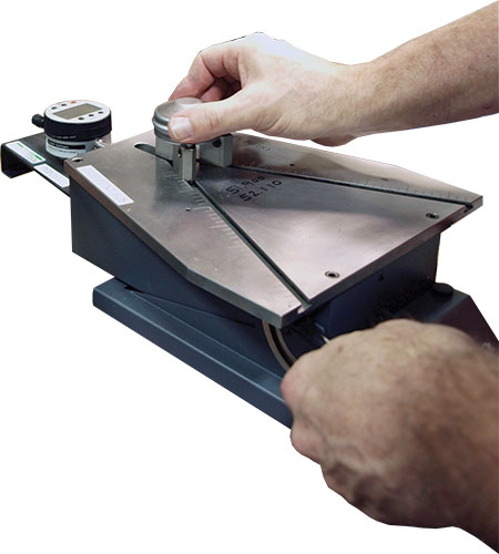

Tolerances are tight to accommodate press-fit assembly—±0.2 mm on OD and 0.5 mm on draw height. The press operator periodically visually inspects parts exiting the tool for burrs, and employs a test gauge to measure part OD and runout. And, with every coil he performs a push-out test in the company’s quality lab, press-fitting the part onto a block and recording the amount of ft.-lb. needed to remove it.
