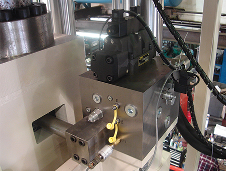

Wilson: We often hear from metalformers about wanting to close daylight as rapidly as possible, but they’ll hit certain limitations in this effort. The main limitation is cost. Adding pump flow, a primary method for increasing press speed, may require adding an entire circuit to the press. The key: Examine the applications—specific requirements may be more important than speed. When buying a new press, merely jumping from one frame size and motor to the next brings a significant cost jump with little corresponding increase in speed.

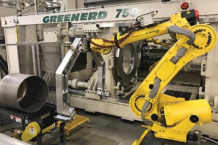

MetalForming: Can adding automation help reduce cycle time?
Wilson: Yes. If loading and unloading result in bottlenecks, a robot can greatly increase throughput. Hydraulic presses have become much more sophisticated in just the past 10 years, with robot integration now a simple task—and robots solve a lot of problems. Just manipulating a part to pull it out of the press may require greater press daylight for an operator than for a robot arm, maybe a few feet as compared to a few inches, and robots make the process much safer.
Manufacturers recognize the dangers surrounding equipment, and robots mitigate that, reducing cut risks due to handling sharp sheetmetal and other health risks from handling bulky, heavy and awkward parts. We recently integrated robots into one application where an operator easily loads a flat blank, but has difficulty removing the resulting awkward part. Previously, the press would open, the operator would manipulate the part out of the press and walk it over to a stack, then walk over to pick a blank, and walk it over to the press to load—so many steps here. Now, a robot pulls the part through the back of the press while the operator feeds the next blank. Robot integration brought huge cycle-time reductions.
Heavy blanks and parts also become candidates for robot integration and resulting cycle-time savings, while reducing ergonomic risks and combating operator fatigue.
