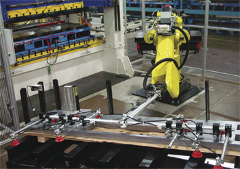

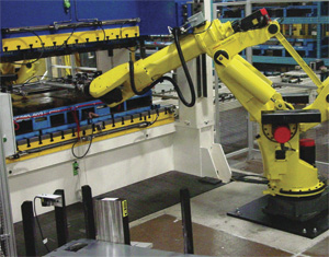

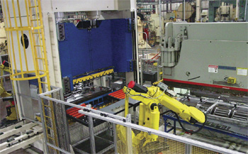

…features press-tending robots (refurbished Fanuc models) stationed at the front and back of the press. One robot feeds blanks into the die and the second robot moves formed parts out of the press and onto the bed of a press brake for additional processing. The production cell also includes automated conveying of stamped and fabricated parts to a manual resistance-welding station, where small reinforcement pieces are assembled to the panels.
With the cell’s design calling for robots in front and back, dies must move in and out of the press through the window. Here’s where the flexibility afforded by a hydraulic press paid off yet again. To accommodate through-the-window die changes, Macrodyne customized its 400-ton 48-in.-bolster press to create 52 in. between uprights.
A robot stationed at the rear of the hydraulic press moves stamped parts from the die to the bed of a 12-ft. press brake for additional processing.

The press brake is a 350-ton 12-ft. Cincinnati—refurbished and added to the cell by system integrator Promatech (also in Milwaukee). In fact, Promatech oversaw the entire cell’s specifications and acquisitions.
