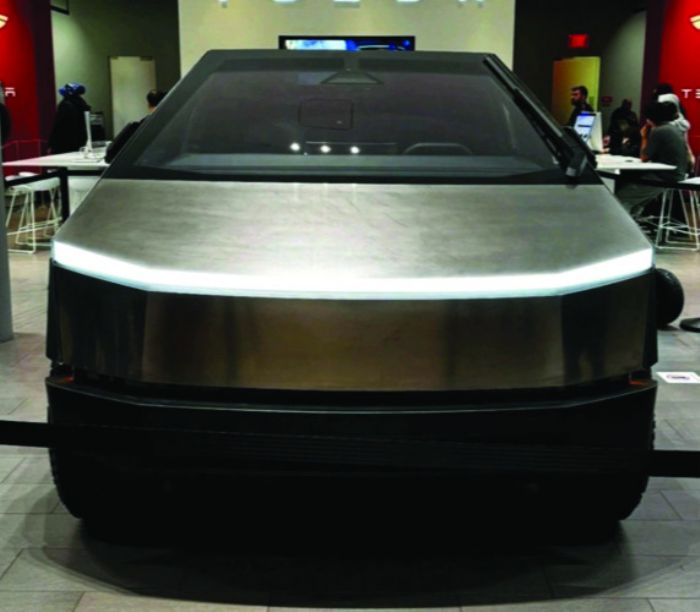

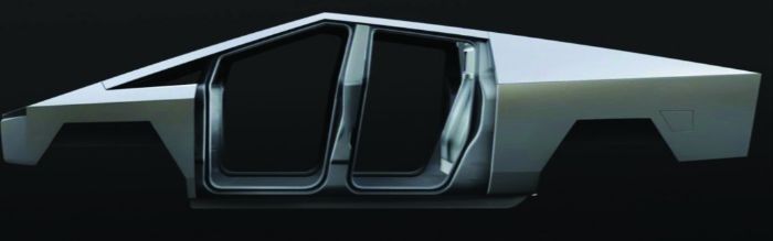

2. Which parts of the Cybertruck are hot stamped?
Ausmann: Tesla hot stamped the double-door rings. That was the first hot-stamped part that Tesla had ever produced internally at any of its plants.
