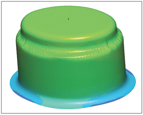

Puckering in a safe zone
 Fig. 1—Puckering in a safe zone

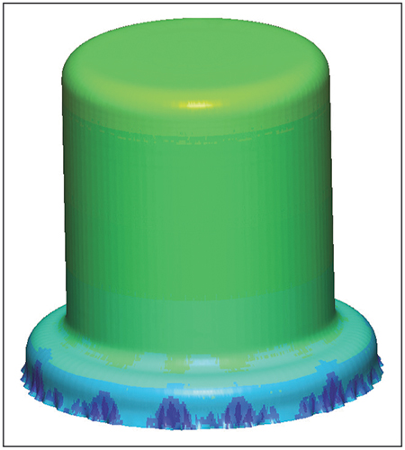

Failure using material thickness for clearance
Fig. 2—Failure using material thickness for clearance

A word of caution: It is not sufficient simply to achieve green results, where all thinning strains fall within the safe zone on the forming-limit diagram. Although the thinning strains in the reduced diameter fall well within the safe zone (Fig. 1), the material still puckers when deformed into the smaller ellipse. One-step solvers cannot detect this phenomenon, and not every incremental code can visually depict this type of defect.
Modeling the tooling geometry for incremental analysis requires great care and understanding of the forming process. Fig. 2, for example, indicates a failure near the bottom of the deep-drawn cup. An inexperienced analyst might assume that the part cannot be drawn to this depth, based on the failure. However, an analyst who understands that the flange of a deep-drawn shell will thicken as the blank diameter is reduced would provide additional clearance between the punch post and the die cavity.
The cup in Fig. 2 was produced from an austenitic stainless steel, which can thicken as much as 40 percent per side at the open end of the drawn shell. The analyst needs to modify the virtual tooling (in the computer) to provide material-thickness clearance plus an additional 40 percent per side at the die opening. This additional clearance gradually tapers back to sheetmetal thickness per side near the bottom of the cup. Reiterating the forming process with this modified tooling configuration produced the results shown in Fig. 3.
