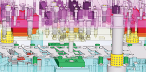

Die-Design Timesavers
Designers find that when adding specialized 3D die-design software to their 3D CAD software, they can dramatically reduce design time—by as much 30 to 50 percent depending on die size and complexity.
One immediate timesaver is the ability to flatten complex-shaped 3D stamped parts using finite-element-analysis (FEA) software. Some companies include FEA in their die-design software packages, while others offer it as an option. And, some FEA software goes beyond flattening and can automatically generate models for the intermediate part forms based on user input.
Die-Design timesavers
In less than 5 min., an insert can be added to a plate along with a shim or backup plate, with proper clearances for both, along with various corner treatments for the cavity in the plate receiving the insert.
While these FEA tools prove very handy, they will not replace dedicated FEA forming-simulation software packages, which prove particularly useful when working with complex stamped parts. These dedicated FEA programs allow the designer to simulate forming and predict numerous outcomes including wrinkling, failure and springback—tasks that challenge even the most experienced tool and die maker—with incredible accuracy.
When designing dies for parts that have only linear bends, often the 3D CAD package alone cannot unbend the parts, but the die-design unbending software can. When the software unbends a part, it also can automatically calculate each bend’s k-factor. After parts are flattened or unbent, the software then can generate a strip layout, with punches, often in just a few minutes.
Die-design-specific software packages also feature unique tools and utilities that significantly shorten the design process, such as the ability to quickly create cutting and forming punches. The software then will automatically cut all of the cavities through all plates in the die, applying the correct clearances and tapers. In less than 5 min., an insert can be added to a plate along with a shim or backup plate, with proper clearances for both, along with various corner treatments for the cavity in the plate receiving the insert.
Some die-design software packages also include tools specifically for round parts. A designer can accurately process the intermediate steps for a round part and lay out a strip in ust 10 to 15 min., including the stretch webs that carry the part. Also available: a graphical preview of one part overlaid on the previous part, or a preview of the part as it enters and makes initial contact with the die cavity.
Standard Component Libraries
The standard component libraries included with die-design software house specifications for several different brands of components and nearly every type of component you might need in a die, including pierce punches and pilots, springs and nitrogen cylinders, guide posts and bushings. No longer must the designer download specific models from a vendor website, and then cut the holes for them, since the software creates the models on the fly. And, in the case of a nitrogen cylinder, the proper stroke length is automatically applied to the solid model of the cylinder; tonnage force is automatically calculated; the hole is cut for the cylinder and all plates it crosses though; and, finally, the screws that retain the cylinders are automatically created and inserted. All of this happens with a single mouse click after the designer has set the parameters, and the user can see the graphical representation of the cylinder before this mouse click.

Several downstream benefits result from the use of 3D die-design-specific software, thanks in part to animation capabilities. Some software animates only the strip itself, while other packages provide full animation showing the die operating as if it were in the press, allowing designers to dynamically check for interference as the die is operating. Animation includes motion of stock lifters and pressure pads, stripper travel, die opening and closing, and the strip feeding through the die to its next progression.
During the animation, the designer can apply filters to view only the lower half of the die along with the strip lifting and advancing and forming, or only the upper half and strippers, etc. He can zoom in and out and manipulate the model at will.
In general, while 3D design adds a great deal to the visualization of a die design, the animation and filtering technology takes die design to a whole new level, helping designers dramatically reduce debug and development time in the press. Also, since the designer’s die model includes any 3D form blocks that typically would be modeled by a CAM programmer, the back and forth communication between designer and programmer is eliminated. The entire design can be in one model rather than using a mixture of 2D design and 3D CAM models.
