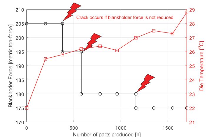

Fig 1A study conducted at a European automotive OEM shows that a door inner stamped at 8 strokes/min. causes tool temperature to increase by 6 C after 1700 strokes, over about 3.5 hr. To stamp parts without failure, blankholder force had to be reduced after several hundred strokes (Fig. 1).
In a typical die buyoff, most companies will not stamp this many parts. After the stamper accepts the die, cracks may still appear during the ramp-up tests (also called stress tests), after a few thousand strokes. These cracks typically could be avoided by applying more lubricant―if the stamper does not have a dry press shop―or by reducing the blankholder force. While both solutions may cure the cracking problem, wrinkling might result.

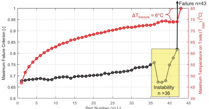

Fig 3Fig. 3 shows the maximum temperature of the punch radius (the hottest part of the die) and the maximum failure criterion for 43 consecutive strokes. The conditions were simulated for a mechanical press with a 916-mm stroke running at 8 strokes/min. As seen, the first stroke resulted in a failure criterion of 0.68, considered “safe” by most die designers. This value increases to about 0.75 in 35 strokes—still safe. Then a brief period of instability is observed where the failure criterion reduces for a while. This instability also is observed in other simulation models with higher stroke rates and using link-motion presses. After the instability, the failure criterion surpasses 1—the part has failed. Here, the 43rd part exhibited splits. In most cases, when the part fails the simulation software calculates an increase in punch temperature (Tfracture in Fig. 3); this may not be observed in the press shop.

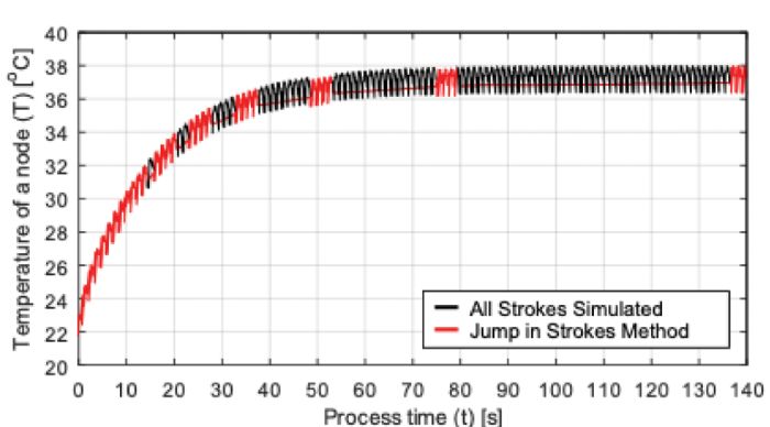

Recently, as described in a paper presented at the 23rd International Conference on Material Forming, ”A Speed-up Method for Numerical Simulations of Multi-Stroke Cold Metallic Sheet Forming Processes,” the authors discussed a “jump in strokes” simulation process (Fig. 4). Using this process, several strokes are not simulated but only estimated through calculations. The method was tested on a small 29.5-mm-dia. stainless-steel part used in shaving machines; and on a much larger part—a spare wheel well for a midsize car, 1750 by 1040 mm, of BH180 steel. The authors claim to reduce the CPU time by 60 percent.
