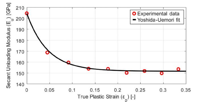

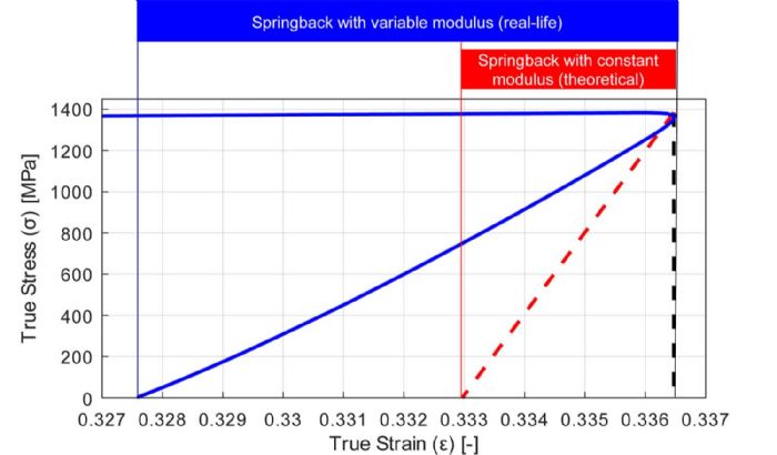

Unloading
Should the flow stress fall below expectation, a die designer should overpredict springback. However, we often will underestimate it because we assume a constant unloading modulus, which may decrease with plastic strain. Catching this effect requires a load-unload tensile test—relatively easier than a tension-compression test as it does not require anti-buckling precautions. Fig. 2 illustrates the output of such a test on a TWIP950 AHSS specimen. Unloading moduli then are fit to the Y-U model (Fig. 3).

Fig 4It is clear and convincing that the unloading modulus significantly affects the ability to predict springback. Still not convinced? See Fig. 4.
