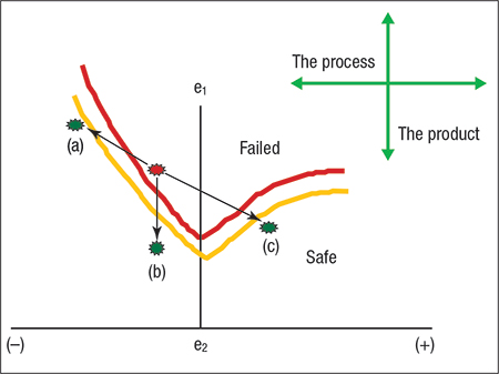

Fig. 4—Strain points must be positioned under the forming-limit curve to be considered safe.

Why did the draw bead additions work? For simplicity, let the red starburst in Fig. 4 represent a set of failed strains on the stamping. Those strains must be positioned under the forming-limit curve to be considered safe. One could try to move the critical strains to position (b) by reducing drawing strains in this area. But this would require a change in part design. Another option is to move to position (c) by changing from a drawing process to a stretching process, but that requires major tooling and process modifications. The best solution is to increase the amount of straining (by adding draw beads) and shift to position (a). MF
