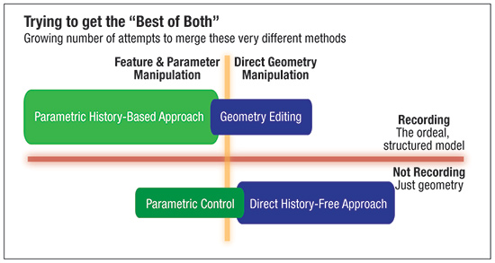

In the early to mid-1980s, work by Sam Geisberg (a Russian immigrant and mathematics genius) and others sought to combine the CSG tree structure with b-rep primitives, so that the b-rep primitives could be created with sketches. Any primitive shape could be defined and used in the model creation. These sketches were parametrically controlled and managed as elements of the feature tree. As such, the resulting b-rep primitives (features) were parametrically controlled. This combined the robustness of b-rep with the editability of CSG and created parametric modeling, also called history-based or feature-based modeling.
As parametric modeling became the industry standard for 3D mechanical CAD, Hewlett Packard worked to develop a different to make b-rep more flexible. It sought to remove the need to understand design intent before beginning the modeling process. Staying with pure b-rep, HP developers found s to make the software more flexible, and their development work led to the creation of dynamic (or direct) modeling. (The organization responsible for mechanical CAD at HP separated from HP in 2000 and became CoCreate Software, purchased by PTC in 2007).
Fig. 1
With direct modeling, any 3D geometry can be fully manipulated and integrated regardless of how it was created, or the CAD tool used. This reduces the need for modeling standards, improves interoperability and reduces the amount of model recreation.
