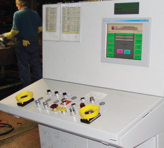

“In these downsizing times, metalformers are looking for efficiency, and we are achieving that through automation of control systems,” explains Mary Tice, vice president for press automation at Helm Instrument Co., Inc., Maumee, OH. “With PLC-based control packages, we can integrate all of the press-line components into one common operator interface.”
The advent of PLCs has allowed for greatly simplified control-system expansion, with modules added wherever along the press line that data gathering is required. How simple has it become?
Installing junction boxes on equipment and running interconnect cables back to the control package can accomplish the task, made easier as wiring modules and cables are embedded into the control package, according to Tice.

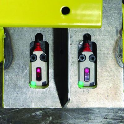

“The automatic-setups module can automatically adjust shut height, counterbalance and as many as seven cushions,” he says. “The analog die-protection module can perform in-die measurements and drive servo motors to make in die adjustments.”
In a nutshell, control manufacturers have in recent years developed smarts into their packages. One such illustration comes from Link. Should conditions indicate presence of a bad or missing part in one station of a transfer or progressive die, the bad or missing part can be tracked as it progresses through the die. This allows for methods to adapt to a missing part—for example, ignoring sensors in missing-part locations—or ejection of a bad part at a later station in the die.
