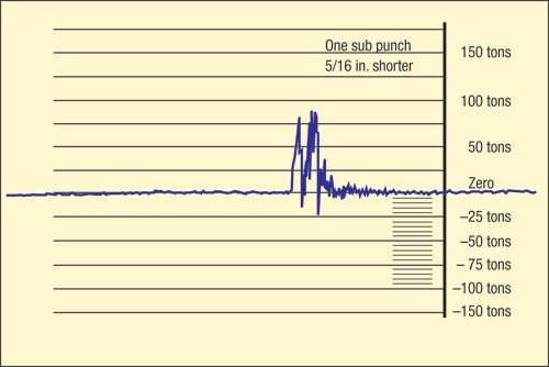

Waveform signature analysis (Fig. 2) provided a to measure die-timing opportunities to reduce the destructive negative reverse load on the press. Shown is the waveform signature of the stress-strain relationship when cutting off and piercing two holes in the part. The data was taken with a chart-recorder speed of 8 in./sec.; the vertical axis indicates strain or force, the horizontal axis represents time.
Fig. 2—This chart recording displays the waveform signature of a combined punching and cutoff operation, and points to excessive snapthrough (or reverse load).
The press speed of the waveform signature is 60 strokes/min. Even at a chart speed of 8 in./sec., the waveform trace distance from initial contact of the punch on the workpiece until it breaks through is very short. The portion of the waveform from initial punch contact to breakthrough occurs in 0.20 in. of chart travel, or 25 msec.

A 300-ton straightside press was used for this operation. The allowable reverse load is 30 tons—point A of Fig. 2 illustrates a peak load of 191 tons, well within press capacity. The reverse load (B) is 87 tons, nearly three times the allowable amount. The die was immediately taken to the repair bench and one punch shortened by 0.312 in. Balanced angular shear was ground on the punches and the parting punch.
Careful timing of the cutting sequence resulted in a tonnage reduction at the moment of snapthrough to 200 tons—the reduction in shock and noise proved to be dramatic, since only half the tonnage produces only half as much press deflection, or 0.040-in. The resultant snapthrough energy: only 667 ft.-lb., a nearly 75-percent reduction.
Fig. 3—Waveform signature of the operation illustrated in Fig. 2 after modifying the die by adding timing and balanced shear.
Fig. 3 illustrates the improvement achieved by modifying the tool. Peak tonnage dropped to 82.8 tons, less than half the initial value, and reverse load dropped to 22 tons, about one-fourth the former value.

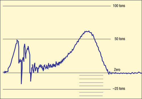

Fig. 4—The waveform signatures of a combined punching, cutoff, and joggle bending operation.
Fig. 4 illustrates the waveform signature of a combined punching, cutoff and joggle-bending operation. Here, AISI-SAE 1039 steel 0.500-in. thick by 2.0 in. wide has two holes punched, and a 0.562-in. joggle formed. The part, an engineering-class chain sidebar, also is cut off in this combined operation.
The die is correctly timed, and snapthrough energy release is well below10 percent capacity of the 300-ton straightside press used for the operation.
