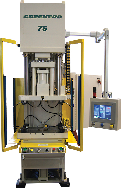

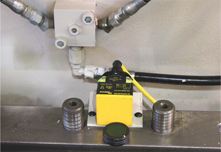

Greenerd also developed a program that allowed each die to be viewed with an RFID reader located on the throat plate of the press. The RFID system sends the die information directly to the control, which calls up the correct program for that particular part run and inputs the proper press settings. A job doesn’t run until the control has read the dies and determined that the die halves match.

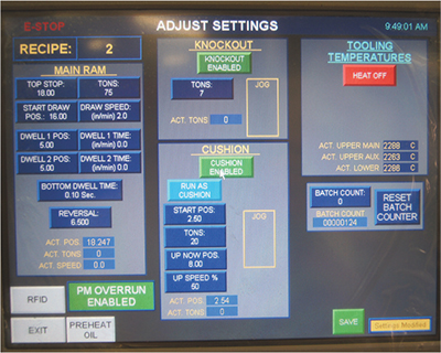

The upgrade also included installation of a pressure and linear transducer, enabling control of stroke depth and tonnage via the touchscreen. Recipes via these readings then can be stored for future access, ensuring proper settings job after job.
Preventive Maintenance Assured
When production ends, the touchscreen displays the total number of cycles run using the die, and stores this information. It also notifies personnel of the number of useable cycles left on that tool—a low number triggers personnel to remove the die for service. Following maintenance, the control resets the cycle count for that die to zero.
