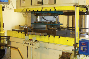

Another part of Amburgey’s safety job: personally install all safety guarding and sensors on machinery.
“All of our automated machinery employ safety light curtains of various lengths,” he explains, “and for die protection we use lasers to detect part ejection or in some cases mini-screens that function similarly to light curtains but with much faster response times. And we employ hard guards wherever required by OSHA—if we don’t have safety light curtains around the equipment or don’t have two-hand controls, we must use hard guards. So we guard the sides and the backs of all of our equipment with light curtains across the front, though we do use light curtains for complete perimeter guarding on some of our machinery. And I’ve updated all of our machinery with dual-processor, solid-state controls to replace the old relay logic.”
