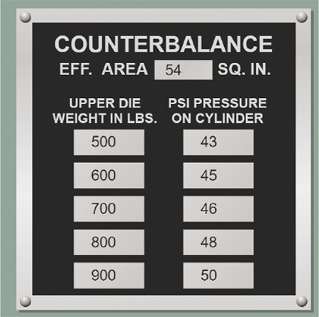

Most presses include a chart that specifies the correct pressure setting for various upper die weights, similar to the one shown here.

Counterbalance Pressure
Press-slide counterbalance systems, found on all but the smallest presses, offset or neutralize the weight of the press ram and upper die assembly. One method of counterbalancing is an air counterbalance system. This requires the setup person to adjust a pressure regulator to a value that will neutralize the weight of the slide and its upper attachments. Safe operation requires the correct adjustment of the press counterbalance.
Most presses include a chart that specifies the correct pressure setting for various upper-die weights, similar to the one shown in the figure. Presses designed for quick die change (QDC) may have an automatic counterbalance adjustment feature. In most cases, the setup person determines the correct pressure setting and manually enters it into a database. Correct data entry and careful maintenance of all systems functions are essential.
During die setup, a properly adjusted counterbalance neutralizes the weight of the ram and tool on the shut-height adjusting screw(s). This makes it easier for the adjusting motor to rotate the adjustment screw(s) and helps prevent premature wearing of the adjusting screw(s). A balanced press ram also helps reduce drivetrain gear wear and allows the press to operate more quietly, while improving stopping time.
In production, a properly adjusted counterbalance system reduces the effective weight that the drive system must lift after the press has gone through the bottom of its stroke. This permits all of the electric motor’s energy to go toward regaining flywheel speed that was lost stamping the part rather than wasting the motor’s energy on lifting the ram.
How important is counterbalancing? Important enough that OSHA requires information regarding upper die weight be made available to the die setter to enable proper counterbalance adjustments. The total die weight of the die assembly also must be known to avoid overloading die-handling equipment.
Stamping the upper and total die weight on the die is the required method, unless the company can make available a foolproof alternative, such as written instruction—including the upper-die weight. OSHA requires that the weight be stamped and not marked or painted because stamping this information eliminates the risk of repainting an incorrect figure on the die.
