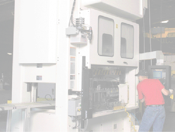

New Standards for Servo Presses, Press Systems and Perimeter Guarding
The introduction of direct-drive servo presses until now has represented a category of equipment that existing standards did not address. All previous versions of B11.1 have covered only full-revolution and part-revolution-clutch mechanical-power presses.
The presumptive B11.1-2008 standards now have design and construction requirements that address the new drive system and unique modes of operation possible with servo-motor-driven mechanical presses.
Also, previous ANSI B11.1 standards have tended to address hazards associated with the press and dies while neglecting hazards associated with an increasing array of ancillary and auxiliary press-system equipment. The 2008 B11.1 standards add safety requirements for “hazards associated with press-production systems other than (press) point-of-operation hazards,” including feeding, transfer, conveyer and other equipment and items.
Where previous B11.1 standards have addressed guards and devices for safeguarding each individual press point-of-operation, this often is not possible for automatic press systems using single or multiple presses, robots, feeding or transfer equipment, moving bolsters, and automatic part- and scrap-removal equipment. For years, coil-fed presses, tandem presses with blank and part transfer, and transfer presses have used perimeter guarding to protect individuals from multiple points of operation and coil- and blank-feeding equipment. The presumptive B11.1-2008 standards include requirements for perimeter and area safeguarding of multiple press-system hazards.
