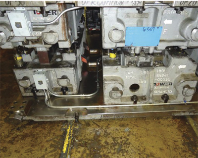

Electrician’s conduit, with the appropriate fittings and mounting hardware, protects the sensor wiring.

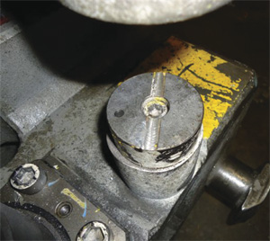

An electronic sensor mounted within a stop block monitors shut height.
The craftsmanship exhibited by Moore and Reynolds is evident in the they protect the wiring in the tooling. They meticulously route electrician’s conduit, with the appropriate fittings and mounting hardware, to protect the sensor wiring. The sensors are bunk-ered within blocks of steel or within existing tooling components (such as the lifters) to protect them from accidental damage as the tooling moves in and out of the press. Cabling from the die-protection control is comprehensive in that it contains the ability to connect scores of sensors, if needed, with a robust military connector. As a result, die-change times are minimally, if at all, affected by the addition of the sensors.
