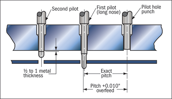

One often-misunderstood aspect of die setup is proper setting of the timing of the feed release. If not set properly, the strip material may slide backwards after the feed releases the material and before the pilots have entered the pilot holes. To aid the setup person, make the first pilot with an undersized nose longer than the other pilots (Fig. 3).
