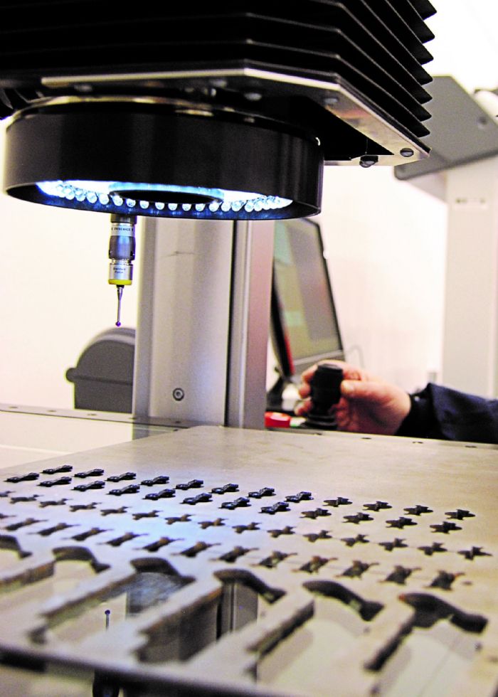

“The image area is lit from different directions, and then a series of LEDs around the camera lens enables users to provide light in various orientations,” O’Hare explains, citing typical flexible setups. “The system is calibrated for a particular type of lighting, a particular type of camera and other factors. No need for users to set up unique shop-floor lighting.”

Such applications might employ multiple measurement methods, according to O’Hare, including a CCD camera to measure straight ahead—say, to confirm hole locations on one part face—and other methods for more challenging side features such as the depth of a groove.
“Here, a focal white-light sensor may be employed,” he says. “Though more expensive, this sensor is highly accurate, providing precise depth measurement.” Such multi-sensor capabilities, notes O’Hare, are found in the Optiv Performance CMMs offered by Hexagon Manufacturing Intelligence.
Hexagon-Optive-near-line-inspection-complex-featuresIncorporation of various measurement methods point to the complementary nature of inspection technology and its availability to metal formers, enabling use in all manner of applications. Optical systems may employ the aforementioned touch probes in near-line inspection to measure deep features, a task impossible with optical measurement alone, and/or employing the white-light sensors for tinier depth features.
