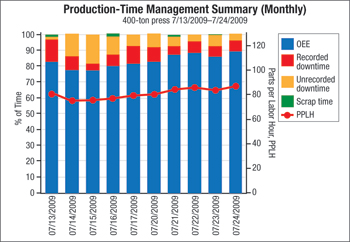

A critical goal for the tracking system was to create simple and effective visual outputs. As a result, the team developed a new, more meaningful method of displaying OEE (Fig. 1).
We achieved the chart by combining, as a ratio, the inverse of OR, PR and QR with OEE to form a stacked bar that visually represents 100-percent efficiency.
Production-Time managemant summary
Fig. 1—A new, more meaningful method of displaying OEE combines, as a ratio, the inverse of OR, PR and QR with OEE to form a stacked bar that visually represents 100-percent efficiency.
The chart allows a very simple trend analysis of PR, OR, QR and OEE over days, weeks or months. Its simplicity makes it easy for all associates to understand. Other benefits with the system include standardized and consistent detailed downtime codes, a variety of graphs to support trend analysis, and pareto charts to show critical downtime items.

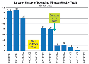

12-Week History of Downtime
Fig 2—Other benefits with the new OEE system include standardized and consistent detailed downtime codes, a variety of graphs to support trend analysis, and pareto charts to show critical downtime items. One key output graph is a standard 12-week downtime-code history graph such as that shown here for a 160-ton press, tracking how often parts would intermittently fall off of and jam the conveyor and cause unplanned downtime. In this case, the graph helped verify that the developed and implemented corrective action proved effective.
To make more of an impact, we decided to outfit the presses to allow us to electronically log press operations and to track stoppages. Operators then could use this information to identify all downtime. We wired a stopwatch-type device into the PLC of the presses that would run any time that a press stopped. These stoppages were displayed for each operator to see and use when entering downtime into the OEE system at each press. The result was a lost-time reduction of 2 to 3 percent, and improved downtime-logging accuracy.
As we sliced the data by press, part, shift, downtime code and other variables, we identified many previously unrecognized issues. For example, at a 160-ton press, parts would intermittently fall off of and jam the conveyor, causing unplanned downtime. Being intermittent, it wasn’t deemed a severe problem, but when downtime was measured over a month of production, it actually made the top-10 list of downtime causes for the plant.
One key output graph we designed was a standard 12-week downtime-code history graph. This graph (Fig. 2) allows anyone in the plant to review the trend of a particular downtime. In this case, we used the graph to verify that the developed and implemented corrective action proved effective.

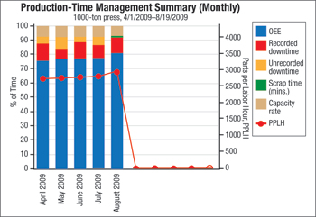

Production-Time Managment 1000 ton press
Fig. 3—New time-management summaries now feature capacity rate (CR)—the ratio of actual cycle time to machine maximum-SPM cycle time—and integrate CR into the existing stacked bar chart. As a result of this new charting, OEE activity now includes an SPM improvement plan focused on reducing lost capacity and increasing CR.

Consider, for example, a 1000-ton press with a manufacturer’s rating of 60 strokes/min (SPM). Since not all parts can run at 60 SPM, we essentially have lost capacity (similar to lost time related to PR). So, a part running at 45 SPM has 25-percent lost capacity. Note also that increasing SPM from 45 to 60 represents a 33-percent increase. That is a significant capacity boost, and you get it for free.
Taking all of this into consideration, we needed a to mathematically capture this on a part-by-part basis. The first solution was to simply change all of the cycle times in the system to be based on 60 SPM. While that does work, in the traditional OEE formula that loss shows up as PR (lost time). For example, if the 45-SPM part had 3-percent lost time before the change, after the change it would be around 28 percent. When that happens, the associates can no longer use PR as a measuring stick and the actual lost time creeps up.
With brainstorming, we were able to isolate this factor by calculating the ratio of actual cycle time to machine maximum-SPM cycle time. The new ratio was dubbed capacity rate (CR). This preserved PR for the associates to monitor their downtime reporting performance. Using some creative formulas, we were able to integrate CR into the existing stacked bar chart. CR varied press to press, and in some cases we were losing as much as 20 percent efficiency and capacity (Fig. 3). As a result, our OEE activity now includes an SPM improvement plan focused on reducing lost capacity and increasing CR.

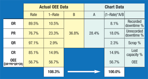

 New OEE equation
 Fig. 4
We also found that our welding and assembly areas could use CR to identify the gap between actual and target cycle times for each line. Actual cycle time here would represent the current cycle time that a line can physically achieve. In both cases it isolates cycle-time gap to CR and ensuresthe PR reflects only lost time against the actual cycle time.
In the name of continuous improvement, we created a new OEE equation: OEE = OR x PR x QR x CR (CR = actual cycle time/optimal cycle time). It’s important to note that CR is a fixed factor independent of downtime or output. Therefore, a slight conversion had to be made in order to graph the rates on our stacked bar chart. Although the rates are mathematically lower with CR added in, their ratio remains intact and still can be effectively used to measure performance trends (Fig. 4).
