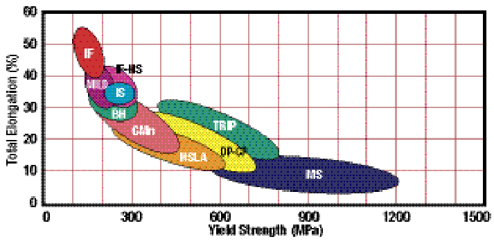

Total elongation
Fig. 2—The curve shows a continuum between total elongation and yield strength for a large number of steel grades.
The concept of boxes in Fig. 1 poses yet another problem. The current definition for the top of low-strength range is 30.5 Ksi, which is the minimum yield strength of bake-hardenable 210-MPa steel. That means the aluminum-killed, draw-quality (AKDQ) steel is both a low-strength and a medium- (or high-) strength steel. A coil of 29-Ksi yield strength steel is low strength, while a coil of 31 Ksi yield strength steel is medium strength according to Fig. 1. The dividing line is arbitrary and, in fact, was higher than 30.5 Ksi many years ago.A popular current example of the continuum of formability properties is the banana curve shown in Fig. 2. Again, the overlapping range of properties of the various types of steels is evident. One can anticipate the changes in steel formability as the yield or tensile strength increases.
