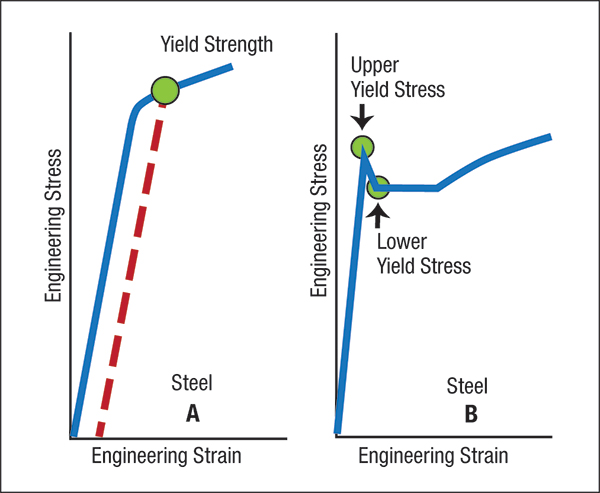

Fig. 1—For a given increment of strain, the steel with the largest increase in stress from YS to TS (steel B) has the larger n-value and greater stretching capacity.
This type of simple qualitative information often will prove more useful in the press shop than will extremely detailed quantitative data. Two candidate steels are evaluated for a part requiring extra stretchability. Both have yield strengths (YS) of 350 MPa; tensile strength (TS) of steel A is 525 MPa, and for steel B is 600 MPa. Immediately one can conclude that steel B should have the most stretchability.
The n-value of the true stress-strain curve dictates the amount of stretchability, by reducing the growth of strain gradients and increasing the maximum allowable strain combinations predicted by the forming-limit curve. The n-value is proportional to the TS/YS ratio—1.5 and 1.7, respectively, for steels A and B. Fig. 1 displays the basis for this qualitative relationship. Note the stress-strain curve of steel B climbs more steeply than for steel A. This is caused by the higher n-value workhardening the steel more per unit of strain. One can make a good qualitative decision without requiring full stress-strain curves from which the actual n-values are computed.
