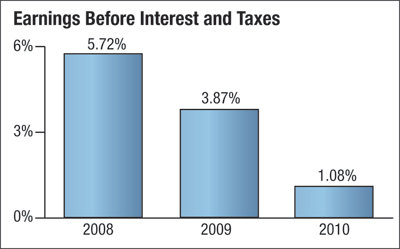

The metalforming industry has been challenged with decreasing revenues and profits. Profitability, as measured by EBIT (earnings before interest and taxes) is at the lowest level, 1.08 percent, since the Precision Metalforming Association’s (PMA) Benchmarking Report started tracking this metric (Fig. 1). During these challenging times, companies are continually looking for s to positively impact profits.

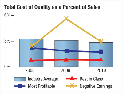

The PMA Benchmarking report calculates the total cost of quality as a percent of sales by combining the costs for prevention, appraisal, internal failure and external failure, all measured as a percent of sales.
Overall, the metalforming industry has done a good job of driving down total cost of quality. The industry average (see Fig. 2) has steadily declined from a cost of 3.21 percent of sales in 2008 to 2.86 percent in 2010.
Total cost of Quality as a percent of Sales
Fig. 2
• Industry Average represents the actual value of the industry average using data from all survey participants.
• Best in Class represents the performance level of the 90th-percentile company without regard to its level of profitability.
• Most Profitable represents the performance of the most profitable companies, the top 10 percent in terms of EBIT.
• Negative Earnings represents the performance of the companies that reported negative EBIT.
The most profitable companies in the report performed better than average, while the companies that lost money generally performed below average, making total cost of quality an important metric for companies to monitor.
