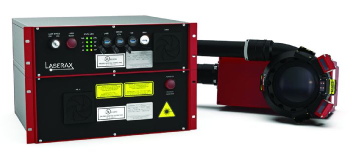

To generate a unique data matrix code for each stamped part, the laser marking system communicates with a stamping press controller (such as a PLC or PC) to obtain the traceability information for marking on each part—a completely automated process with parameters updated within a few milliseconds.

Stamping presses can produce parts at lightning speed, sometimes exceeding 60 parts/min., and speed of production in metal stamping directly correlates with profitability. To keep presses humming, a marking system must identify a part rapidly—in less than 1 sec. for operations exceeding 60 parts/min. Laser marking systems keep up with this production level beyond what other methods can accomplish, with capabilities to impart data matrix codes on each part in as quickly as 0.6 sec.

Use Industrial-Grade Laser Markers
Metal stampers cannot afford costly downtime for extended maintenance or stoppages due to equipment breakdowns. Stamping lines require the use of industrial-grade laser markers that can handle these harsh environments and stand up over time.
For example, surfaces of blanks and coils are often oily, which means that oil and dust particles will release into the air during laser marking. Laser markers must offer protection against dust and liquids to avoid contamination or degradation. As such, manufacturers should ensure that their laser marking systems have three key features:
- IP rating. The laser IP (ingress protection) rating, an international rating, indicates how well laser enclosures resist water and dust. High-volume production processes such as metal stamping generally should use lasers with an IP rating of 54 or above.
- Fume extractor. Laser fume extractors suck up the fumes created during the process and reduce hazardous fumes and particulates. Fume extractors also should perform proximity source capture. Ensure this by positioning the fume-extraction nozzle as close as possible to the source of dust and fumes.
- Air knives/Air blowers. Debris and contamination on the laser lens can cause significant problems. It can degrade performance and lead to marking-quality defects. Air knives, also known as air blowers, deflect debris away from the laser lens. They blow air in front of the lens continuously to prevent dust accumulation and minimize maintenance.
