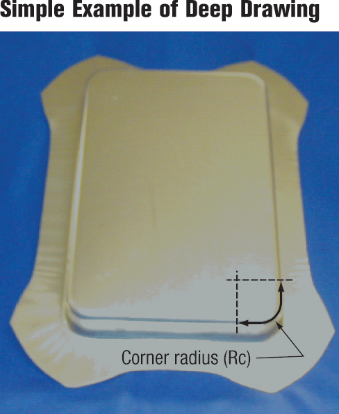

Simple example of deep drawing
Fig. 1
A rectangular box serves as a simple example of deep drawing (Fig. 1). The box contains two opposite modes of deformation. The corner deformation can be visualized as drawing a quarter of a cylindrical cup. The straight walls connecting the corners deform via the bend-and-straighten mode. When forming the box, a large gradient of circumferential compression exists with high compression in the corners but little or none in the sidewalls. In such cases, multiple restraining forces may be required. Because material forming the sides of the box can flow more freely than material forming the corners, metalformers often add draw beads to the blankholder in these areas to further control and direct material flow. Without draw beads, excess material can flow into the sidewalls of the box to create undesirable buckles and waves.

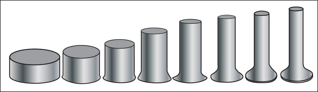

The most predictable deep-draw process, axis-symmetric cup drawing (producing simplified box corners) has the most known design parameters. Fig. 2 illustrates the drawing of a round blank into a cylindrical cup. As the blank is drawn into the die cavity, the remaining material (flange) compresses in the circumferential direction. If not properly controlled, these large in-plane stresses will cause the blank to buckle or wrinkle. The blankholder must provide sufficient force to prevent buckles and wrinkle formation, while still allowing blank material to flow toward the die cavity. Setting blankholder forces too high results in excessive stretching and thinning, causing the material to neck, tear or split.
Drawing of a round blank into a cylindrical cup
Fig. 2

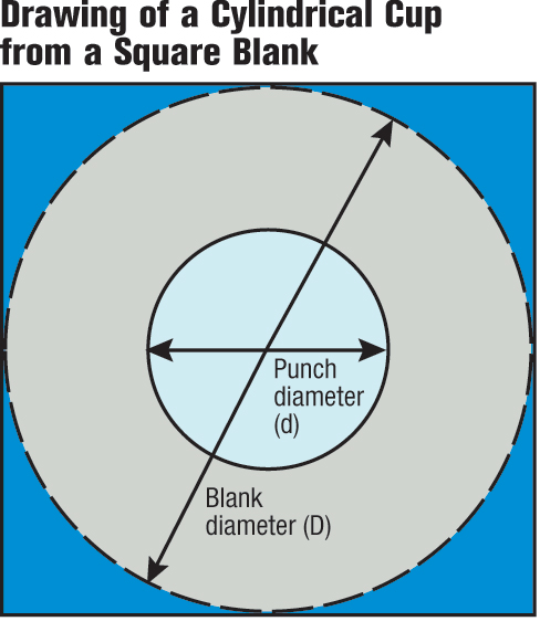

Drawing of a cylindrical cup from a square blank
Fig. 3
More common in these industries: a mathematically related expression known as percent-reduction. To calculate maximum percent-reduction for the example above, use the following formula: 100 (D-d)/D = % Reduction, so that 100 (8.8 – 4.0)/8.8 = 54 percent maximum reduction. Therefore, an LDR of 2.2 and a maximum percent-reduction of 54 percent represent the same amount of maximum cup drawability.
The LDR’s effect can be observed in attempts to draw a cylindrical cup from a square blank (Fig. 3). To achieve the previous LDR of 2.2, blank-edge dimensions are set at 2.2d. However, now all four corners have a draw ratio exceeding the LDR by a significant amount and the cup generates a tear at each of the four corners. To reduce the draw ratio at the corners, metalformers may first miter the corners to make an octagonal blank. This offers improvement but may not be sufficient. The best workable solution: Create a circular blank with a radius equal to 2.2d.

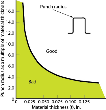

The LDR measured in the laboratory is not the absolute value that must be applied in the press shop. Like all forming operations, the product and die design are just two of many variables in the forming process. The LDR can be tweaked by proper design of punch and die radii based on sheetmetal thickness. The recommended punch and die radii as a function of sheet thickness are shown in Figs. 4 and 5, respectively.
determining proper punch radius
Fig. 4
Redraws Needed for Larger, Narrower Cups
To achieve a good, robust process, die designers do not engineer ratios right up to the LDR, as doing so makes the process susceptible to other variables. For an LDR of 2.2, die design may be limited for production purposes to an approximate draw ratio of 1.9. Achieving a cup with a greater height-to-diameter ratio (Fig. 6) requires one or more redraw dies.
When redrawing operations are required, neither the shell diameter nor height approaches the final part-print size during early draw stages, so there’s no need to use the part-print radii. In fact,using a larger punch radius in the draw operation offers an advantage because the redraw blankholder fits inside of the drawn cup at this radius. This provides for a larger redraw radius on the blankholder, reducing bending and straightening loads for that operation.

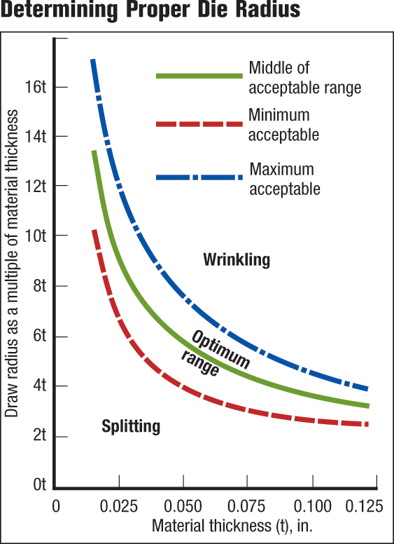

Determining proper die radius
Fig. 5

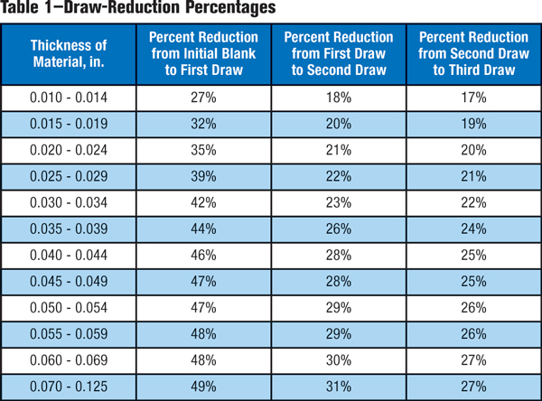

The redraw reduction percentage can never be as high as the first draw because the redraw has more bending and straightening forces, the cup wall in tension is smaller, and the material has been previously workhardened. Consequently, reductions for the first redraw usually measure 55 to 60 percent of the initial draw reduction. For example, given a first draw reduction of 48 percent, the first redraw reduction would be 48 percent initial blank reduction times 0.60, or 29 percent. The next redraw reduction percentage must be less than the first redraw due to more severe workhardening plus an even smaller cup wall in tension. As a rule, all subsequent redraw reductions are approximately 10 percent less than the previous redraw. Thus, given a first redraw reduction of 29 percent, the second redraw reduction would be 26 percent; the third redraw-reduction percentage would be 10 percent less than the second redraw, a 23 percent reduction; and the fourth redraw would be 10 percent less than the third, a 21 percent reduction.
Fig. 6 deep drawing
Fig. 6—Achieving a cup with a greater height-to-diameter ratio requires one or more redraw dies.
Suppose a final reduction is necessary in the fourth redraw, but requires only a 6 percent reduction. Building a fourth redraw tool for such a small reduction may not be cost-effective. Instead, a slight increase in the draw and other redraw percentages could eliminate the last redraw die. However, if the process is already critical, the initial draw and redraw percentages should be reduced to increase the fourth redraw reduction percentage and make it worthwhile. This pattern can be observed in Table 1. Different handbooks provide somewhat different reduction sequences.

Table 1-Draw-reduction percentages
Two types of redrawing methods are direct redrawing and reverse redrawing. Direct redrawing reduces cup diameter by redrawing the cup in the same direction as the first draw. In reverse redrawing, the cup is inverted during diameter reduction. Regardless of the redrawing method chosen, a decision must be made to draw the cup in the first draw operation with or without a flange.

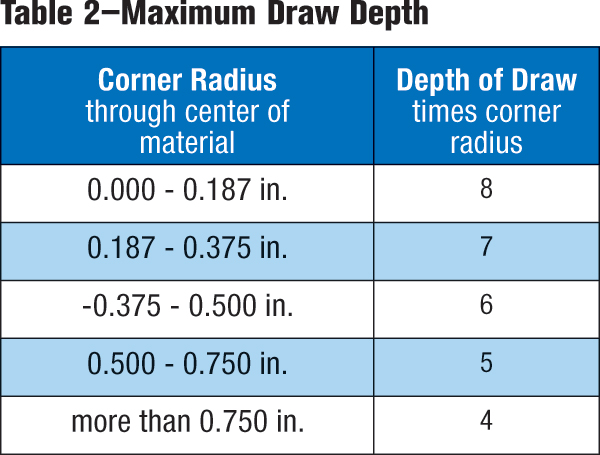

But the primary design factor is the plan-view corner radius and the ratio between the corner radius and the longest straight side of the box.
Table 2-Maximum draw depth
The size of the corner radius can be used to estimate the maximum draw depth for square boxes using tables similar to Table 2. These tables and formability curves reside in die-design and metalforming handbooks. In the absence of other data, these rules of thumb apply:
  • Part depths less than five times Rc: one draw operation required;
  • Part depths from five to 11 times Rc: two draw operations required;
  • Part depths from 11 to 16 times Rc: three draw operations required;
  • Part depths from 16 to 21 times Rc: four draw operations required.

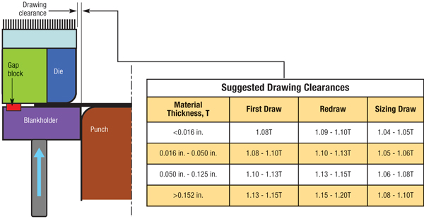

Additional factors to be considered but often overlooked when deep drawing rectangular shells and irregular shapes include providing additional punch-to-die clearance in the draw corners to accommodate material thickening (Fig. 8). CNC machining the punch or die cavity with a simple offset for material thickness will not account for material thickening in these corners. Metalformers also should look to provide relief in the corners of the blankholder, also known as spotting in, to accommodate flange thickening in drawn corners. Forming severity can be further reduced by developing optimum blank shapes, increasing die-profile radius and improving lubrication.
Boxes with nonvertical (tapered) walls are more susceptible to wall wrinkles. Restraining forces must be increased and allowable box height decreased. A box design with tapered walls of 20 deg. may require a decrease in draw depth of 25 percent or more.
Drawing clearances as a function of matrial thickness
Fig. 10

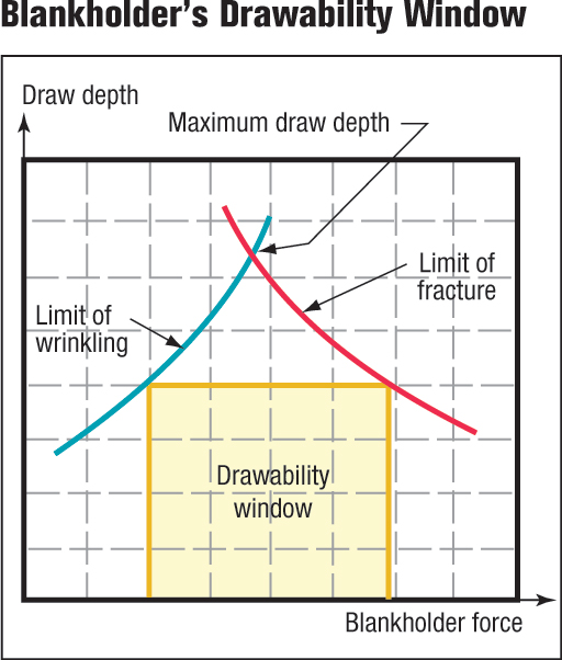

An important sidewall design consideration focuses on the ability to control movement of material from the blank to the die radius and up the sidewall. With several methods available to determine the amount of blankholder force required in drawing operations, the best practice is to use metalforming simulations (computerized die tryout). Forming simulations allow experimentation with blankholder forces until both a high limit (excessive stretching) and low limit (wrinkle formation) are established. The difference between the two limits, the blankholder’s drawability window, is shown in Fig. 11. The larger the window, the more robust the process will be to changes in blankholder pressure. As draw depth increases, the drawability window narrows considerably.
Excessive blankholder pressure can be remedied by using adjustable gap blocks, also referred
Blankholder's drawability window
Fig. 11
to as stand-offs. Gap blocks allow higher blankholding forces without restricting material flow by providing a constant gap between the die face and the blankholder. Gap blocks are initially set at material thickness plus an additional 10 percent to accommodate material thickening due to circumferential compression in the blank.

Logan S. TUE, APR 25, 2023 @ 3:43 PM
Fig. 4 does not make any sense. If my material thickness is 0.072" there is no way that have a radius over 3" is correct. Am I wrong?
Peter U. THU, APR 27, 2023 @ 8:51 AM
Hello Logan, There is an error in figure 4, as you already surmised. The numbers on the vertical axis are missing a decimal point (i.e., should be 2.0, 4.0, 6.0, etc.). The resulting answer (approx 0.35���) should now make sense. Sorry for the confusion and thanks for the heads-up on the error.
