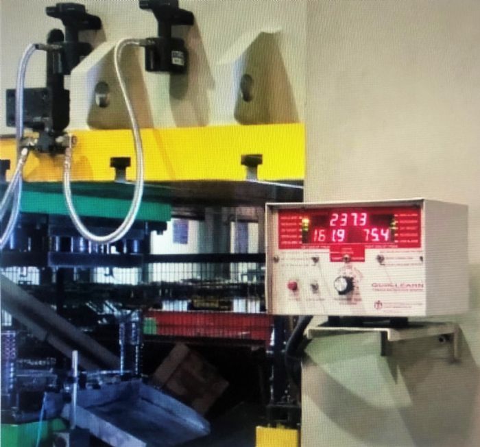

With the stop-circuit issues addressed, let’s discuss the high-alarm settings. Many units have a Setup mode that acts like a bypass switch—valuable when placing a die into the press. This allows the tonnage monitor to start a new job without triggering a nuisance alarm during setup.
Toledo Controls Bypass SwitchHowever, a tonnage monitor unknowingly can be left in this mode and will not provide protection during light-tonnage jobs. For example, with the monitor in Set Up mode, a 1000-ton press will not stop on an overload until its force exceeds 1000 tons. The unit must operate in Run or Automatic mode to activate the high- and low-tonnage limits. A Learn function on a tonnage monitor provides great help in setting precise limits for the particular job being run. A 1000-ton press might be running a job at 200 tons. This Learn function, set at 20 percent, would “learn” the high limit of 240 tons instead of using the maximum of 1000 tons. Most tonnage monitors without a Learn function still offer a method to adjust the high- and low-tonnage limits. For example, an operator can dial it in manually at 240 tons to activate the high-alarm setpoint.

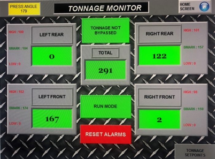

Changing Limits on PLC-Based Units
PLC-integrated tonnage monitoring offers expanded capabilities and enables automatic setting of limits for each die. Recently I worked at a plant with a highly skilled maintenance technician who had no idea how to change the limits on the PLC-based tonnage monitor. These limits were set at the tonnage capacity of the press. The PLC system still needed to be programmed for a specific job recipe, just as with die protection, programmable limit switches and shut height. Otherwise as mentioned, the values would be set to the tonnage capacity of the press. In this case, with a simple PLC program change, the tonnage parameters could be saved, recalled and loaded automatically with a job change.
