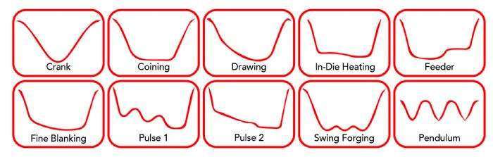

3. How do servomechanical press controls differ from mechanical press controls?
Stroke_ProfilesOne of the biggest differences between mechanical and servo press controls is the use of cam-based functions. These typically use linear distances during stroking instead of angle-based settings, as servo presses have many more special stroke profiles that traditional mechanicals can’t perform.
Servo press controls enable operators to request unique profiles, while customized motion curves allow as many as 20 various segments in a cycle curve, defined by segment position, speed and pause-duration parameters.
Integrated servo press controls on direct-drive and link-assisted servo presses allow an unlimited number of stroke lengths and slide-movement profiles, while supplying full working energy capacity, even at low speeds. With servo press controls, operators can perform a variety of jobs—drawing, restriking, warm forming—in one press.
