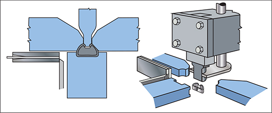

The basic slide forming machine, known as a four-slide, consists of a feeding device, four fixed-position forming slides, and a forming mandrel (center tool) suspended by a bridge support straddling the back tool-slide. The slides are driven by four shafts positioned around the outside of the machine, with the shafts connecting at the corners with bevel gears. This arrangement allows one shaft to be driven by an electric motor. That shaft's motion drives the other three shafts (Fig. 1). Each shaft has cams that drive the slides. Tools, attached to the slides, form the part by cutting wire or strip stock and then pressing it around a mandrel. The shapes of the tools and the mandrel dictate the shape of the final part (Fig. 2).
Fig. 2—Slide forming tools closed around part (left), and with tools open for part ejection (right).
