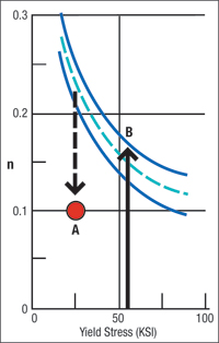

• We order by yield strength and only that value is reported to us from our supplier.
n-Value
Point A shows a steel sample with an n-value below the expected value. Location B indicates the maximum
n-value expected when the minimum yield strength is specified
Is there a of obtaining the n-value from only that single piece of data?
For low-carbon steels that have a single microstructure of ferrite, a historical data band can be constructed (See graph). The n-value decreases with increasing yield strength. The processes used to strengthen the metal also reduce the n-value.
• Sometimes a coil is received that fails in a severe stretch area, while other coils form successfully. Would this be a low n-value problem?
Checking the n-value of the problem coil would be a good first step. This problem is highlighted as point A in the graph. A steel mill or service center sometimes will correct poor shape with an extra heavy temper pass. While the yield strength may increase slightly, a major reduction in the n-value will take place. Other possibilities include a different chemistry, different processing, or even shipment of the wrong coil. The die reacts to the properties of the incoming blank. It really does not care what caused the difference.
• Can you explain why specifying the minimum yield strength of higher strength steels limits the maximum n-value?
The graph shows why this relationship happens. The upper curve is the maximum expected n-value as a function of yield strength. The arrow B represents the minimum specified yield strength. The intersection is the maximum n-value. To obtain a higher n value, one would have to reduce the yield strength below the specification. For this reason, some of the new advanced higher strength steels have complex microstructures that allow higher n-values for the same strength.
