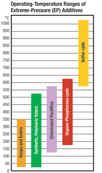

Extreme-pressure (EP) additives in lubricants provide excellent anti-galling tendencies under extreme heat and pressure conditions. EP additives (see below) commonly used in metalforming lubricants are chlorine, sulfur, and phosphorus compounds. When chlorinated hydrocarbons, for example, are added to stamping lubricants, the he generated at the tool-sheet interface releases chlorine and allows it to react with iron in the steel. This reaction forms an iron-chloride film which is an excellent EP lubricant. Sulfur and phosphorus form sacrificial films similarly, each being effective within specific temperature ranges.
