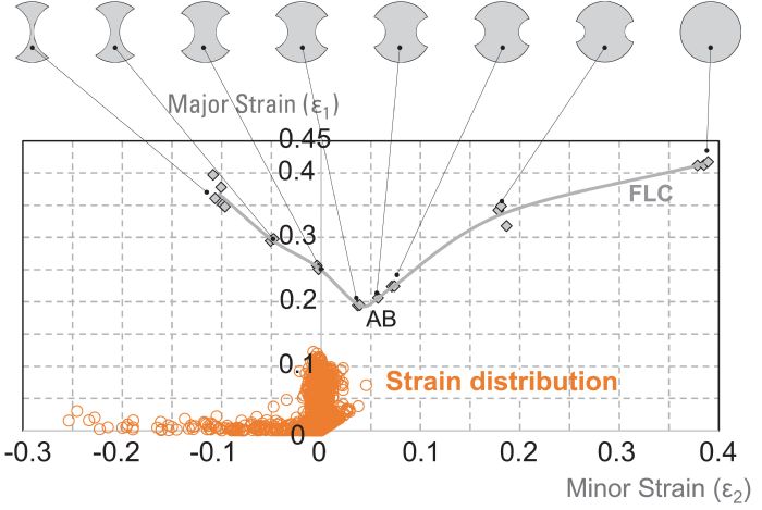

Fig. 1Unfortunately, often we see the terms FLC and FLD (forming limit diagram) incorrectly used interchangeably. Fig. 1 displays their differences.
FLC changes with material type and thickness, and with the material supplier. It also can change from coil to coil and batch to batch, and even within the same coil. In addition, different test methods can result in different FLCs.

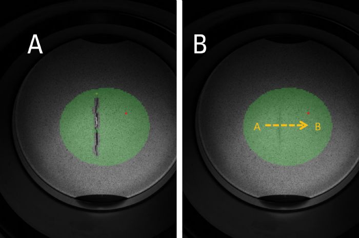

Today, most shops determine FLCs using approximation methods, primarily based on a material’s n-value (strain-hardening exponent) and sheet thickness. As an alternative, we now can use digital image correlation (DIC) systems to determine FLC experimentally. Here, we prepare several Nakajima (shown in Fig. 1) or Marciniak test specimens for different strain paths. We paint the specimens white and apply a black speckle pattern. Each specimen then is clamped around the periphery and stretched using either a hemispherical punch (Nakajima test) or a flat-bottom punch with a carrier blank (Marciniak test) until fracture. The different punch shapes produce different strain paths and, as a result, different FLCs.
Fig. 2-cIn the past, those conducting the test would try to sense necking of the specimen using their fingers. Once they sensed necking, they would manually measure the strain distribution on that section. Now, noncontact optical DIC systems can sense the onset of necking and then measure strain distribution. The operator can set the DIC system to take photographs of the test specimen at given time increments (at least 10 photos/sec., according to ISO 12004-2008) from the time the punch starts to deform the sheet metal until after a crack forms (Fig. 2A).

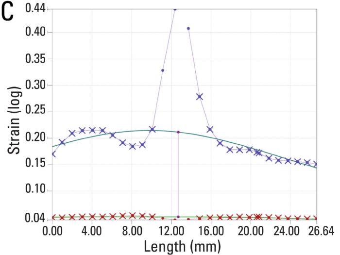

At test completion, the operator uses the last photo before fracture to calculate the strains at the most critical sections (Fig. 2B). A curve fit is applied to find the major and minor strains at the apex, and includes only the data points that have not already necked. Fig. 2C shows the major strain calculation of 1-mm-thick DP590, with minor strain shown in red. For the given geometry, major strain was calculated as 0.211 and minor as 0.051. This corresponds to point AB in Fig. 1.
Developing an FLC requires at least 15 experiments (according to ISO 12004-2008). Confidence in the results increases with the number of experiments. Fig. 1 shows an FLC derived from more than 30 experiments (eight geometries with three to five repetitions). The previous technique of detecting necking by touch and then manually measuring a number of ellipses was time-consuming, with accuracy depending on operator skill. Modern techniques using DIC reduce the operator’s subjectivity in sensing the neck initiation and save time in measuring and calculating strain distribution. MF
