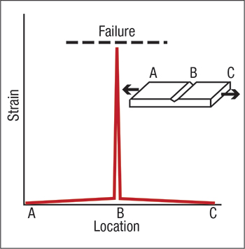

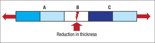

To demonstrate how important n-values are for HSLA steels, a series of graphs describes what happens after elongation of a tensile specimen (Fig. 1). This specimen is uniform along the length except for a deep scratch, gouge or some other removal of steel in area B. This material removal causes section B to have a higher stress than sections A or C. The n-value is zero along the entire strip. When the specimen reaches the yield stress, area B starts to deform—areas A and C remain constant.

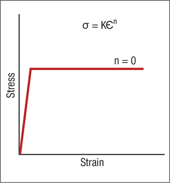

The purpose of the n-value is to increase the strength of the steel as it deforms. Fig. 2 shows that n-values of zero cause deformation to increase without any increase in stress or strength. Zones A and C do nothing because all of the deformation occurs in area B. The high concentration of deformation in area B forms a gradient—a narrow localization of strain that can reach very high peak strains (Fig. 3). Failure is easily reached.

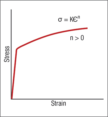

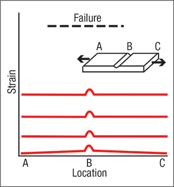

Now assume that the entire strip has an n-value. The steel will start to workharden and increase the stress required for deformation (Fig. 4). Deformation starts at area B. After a small increase in height in area B, areas A and C start to deform and reach the strength of area B. Deformation then continues as areas A, B and C move to higher levels of strain. The higher the strain of the entire location the less importance the bump has in creating failure.
