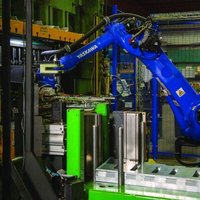

When Lou met with the team at Sukup Manufacturing early in 2022, he learned how the company has been leveraging automation to meet rapidly increasing customer demand for its grain-storage and-handling systems and equipment. One of the latest automation additions at the Sheffield, IA-based manufacturer: a Yaskawa Motoman robot that destacks blanks and tends to two stamping presses to produce flooring supports for use in grain-storage operations. The robot loads 20-gauge steel blanks into a 300-ton mechanical press for forming, unloads the formed part (now a tube section) and transfers it to a hydraulic press for bending.
The press-tending robot at Sukup, installed midway through 2021, automates what had been three manual operations. The result was a 30-percent reduction in cycle time, and the firm was able to transition from three operators to one, allowing it to redeploy two operators into other departments.
